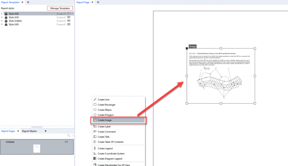

[An...] Posted August 29, 2022 Share Posted August 29, 2022 GOod morning, after I have generate using Python an histogram, how can I plot it and having it in my report? Thank you very much Link to comment https://qualityforum.zeiss.com/topic/1318-plot-an-histogram/ Share on other sites More sharing options...
[Mi...] Posted August 30, 2022 Share Posted August 30, 2022 Good morning Angela, I assume you have generated the histogram using a Package such as matplotlib or similar, i.e., we are not taking about a diagram which is native to GOM Inspect. If this is the case, you can save the histogram to a image file and import this image with the "Create Image" command which you can access in the report workspace. See the attached screenshot to find the corresponding menu item. Link to comment https://qualityforum.zeiss.com/topic/1318-plot-an-histogram/#findComment-4310 Share on other sites More sharing options...
[An...] Posted August 31, 2022 Author Share Posted August 31, 2022 Dear Micheal, thank you for your kind answer. Yes I´m using plt.hist from matplotlib. I will try the solution that you suggest but it looks like what I was looking for. Thank you again. KR Angela Link to comment https://qualityforum.zeiss.com/topic/1318-plot-an-histogram/#findComment-4346 Share on other sites More sharing options...
