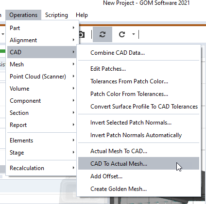

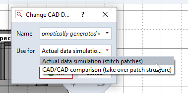

[Lo...] Posted August 30, 2022 Share Posted August 30, 2022 Hi, in case you have the CAD available you can always create a proxy mesh from this CAD as "simulated" actual data. Use the command "CAD to Actual Mesh..." Choose "Actual data simulation". Now you have a CAD and Actual Mesh in your project and can define the volume check. The mesh / actual data will be swapped out once you polygonize a measurement or import data into the part. Currently there is no way to define this check directly on the nominal. Link to comment Share on other sites More sharing options...
[Ti...] Posted August 30, 2022 Author Share Posted August 30, 2022 (edited) @Lorenz Thanks for the reply...Im aware of CAD to Mesh, that is how I program inspections...the problem I have is our parametric script has a line item that 'removes mesh" and then imports a new one. Once you remove the mesh it auto-deletes the volume check. Also, saving a inspect file with our 40MB meshes would blow up our storage space. We are already asking for more space and removing old stuff... I'll have a look at that dropdown you suggested and see if it helps and doesn't grow our file size...im assuming cad to Mesh shouldn't be much more data. Thanks! I'll report back Edited August 30, 2022 Link to comment Share on other sites More sharing options...
