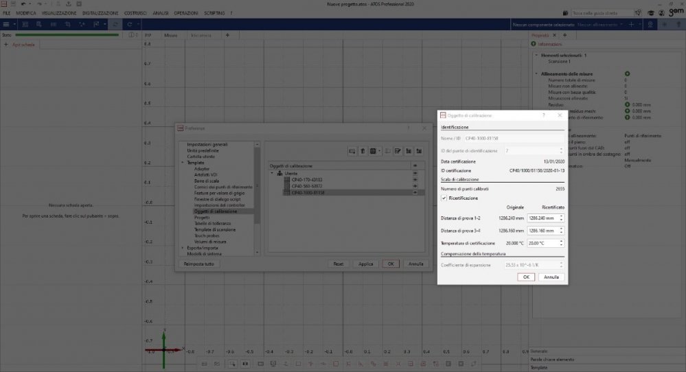

[Fi...] Posted August 31, 2022 Share Posted August 31, 2022 We would like to certify the calibration panels for our Atos Compact Scan sensor, we have our Tritop system available for measurements. We would also like to know if you need special calibration bars or can we use our 2 CFK 1000mm scale bars? Where can I find the procedure for generating the new .calobj file? Thank you very much if you can clarify if we can proceed internally in our company. Best regards Filippo Link to comment https://qualityforum.zeiss.com/topic/1326-procedure-instruction-to-certificate-a-calibration-panel/ Share on other sites More sharing options...
[Da...] Posted August 31, 2022 Share Posted August 31, 2022 Dear Filippo, you yourself can not certify the calibration panels. For more information regarding the re-certification of your ATOS systems, please consult the following FAQ-article. https://connect.gom.com/display/GKB/Validity+of+certification# Also, you can not generate a new .calobj-file. Link to comment https://qualityforum.zeiss.com/topic/1326-procedure-instruction-to-certificate-a-calibration-panel/#findComment-4348 Share on other sites More sharing options...
[Fi...] Posted August 31, 2022 Author Share Posted August 31, 2022 (edited) Thanks Daniel, wanting to further investigate the topic... In the absence of damage, it is possible to recertify the panels by measuring the two characteristic diagonals with Tritop. What are the limitations of this quick method of updating the calibration object file? Is it possible to extract a summary pdf report? Thanks again in advance Edited August 31, 2022 Link to comment https://qualityforum.zeiss.com/topic/1326-procedure-instruction-to-certificate-a-calibration-panel/#findComment-4350 Share on other sites More sharing options...
[Da...] Posted September 1, 2022 Share Posted September 1, 2022 Dear Filippo, why are you trying to change the .calobj-file? Also, keep in mind that there are more information contained in the calibration file than just these two distances. Kind regards Daniel Link to comment https://qualityforum.zeiss.com/topic/1326-procedure-instruction-to-certificate-a-calibration-panel/#findComment-4362 Share on other sites More sharing options...
