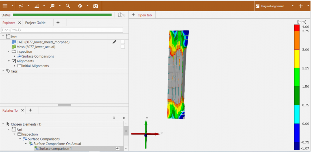

Hello.. novice user here.  I am trying to so a compare between CAD and Mesh.. but am getting some "Grey" areas I dont know how to get a complete colour map through the model.. The ends look good, but there should be a deviation map in the center area's as well.see image attached..

please edit the creation parameters of the surface comparison on CAD in the explorer under "Inspection" and check the "Max. distance". If the mesh is outside of the maximum distance, no value will be calculated.

Thanks.. Looks like I cannot edit Max Distance.. and I need "Professional" for this.. seems like a pretty basic command
Hello Andy,
the parametric (like editing existing checks) is disabled in the free version, but you can create a new surface comparison with a different distance.

Got it.. got a trial of the Professional version and it worked.  Will give it a go and upgrade if needed.
