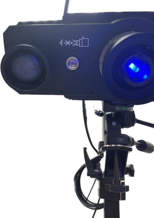

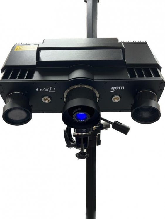

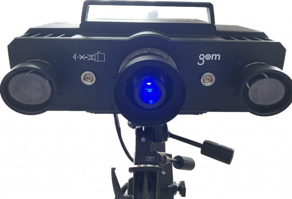

[Im...] Posted September 13, 2022 Share Posted September 13, 2022 Hello All . We have a ATOS 5 System in our reverse engineering Lab. After warming up the ATOS 5 systems the FOG is forming in the lens . Room Temperature - 23 Degree Celsius Closed Door Type Room In summer it more frequently happening FOG is happening on left lens more ( On right lens it happening but he rate is slow ) Every time i have to clean the lenses to before taking measurements. Also if i removed the lenses too frequently the system started to show calibration error . Then i need to calibrate the lenses again . It does not end here , during calibration also the fog is forming which make it difficult to calibrate . Its real issue for us .Need insight with forum member & GOM people , why this is happening . Anybody who is using ATOS system have observed this issues in the past ? It may be happening because of internal heat management system of the device itself ? Or it may be happening because of the external environmental factors ( such as room temp, humidity etc. in the room) Any suggestion or workaround in this regard would be really appreciated in this Thanks in advance. Link to comment https://qualityforum.zeiss.com/topic/1377-fogcondensation-forming-on-the-lens-of-atos-5-system/ Share on other sites More sharing options...
[Im...] Posted September 13, 2022 Author Share Posted September 13, 2022 Here is the new updated image of the FOG on the lens Link to comment https://qualityforum.zeiss.com/topic/1377-fogcondensation-forming-on-the-lens-of-atos-5-system/#findComment-4533 Share on other sites More sharing options...
[Ja...] Posted September 14, 2022 Share Posted September 14, 2022 Hey, a couple of things 1. If you remove the lens covers then you should always recalibrate your system afterwards - they are part of the optic chain 2. I have seen condensation in lens covers before , but in a more exposed environment. i can only guess the room you are in is humid. However , there was a solution from the hardware support team. I would suggest you contact gom hardware support through your distributor. Link to comment https://qualityforum.zeiss.com/topic/1377-fogcondensation-forming-on-the-lens-of-atos-5-system/#findComment-4541 Share on other sites More sharing options...
