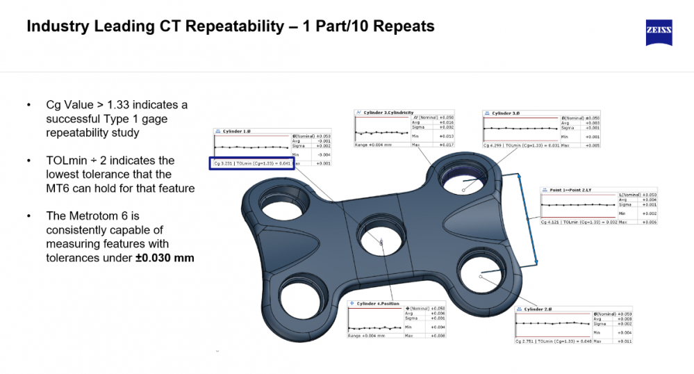

[Jo...] Posted September 27, 2022 Share Posted September 27, 2022 Hello all, Really enjoying reading over the discourse here. Perhaps I spoke with you at IMTS, my name is John Moore. As it happens, I have quite the extensive application experience with the MT6 x Bone Screws. At a basic level I like to broadcast that we can generally handle +-0.030um tolerances on bone screws. Of course, as you all have already alluded to, throwing datums into the mix can often lower this. This then becomes a case to case situation depending on feature size and datum design. Please see the attached example for a demo Type 1 study I did on a bone plate with the MT6. Typically, titanium bone plates and bone screws perform similarly in the MT6 in terms of repeatability. Would love to speak with you further on the topic if these numbers grab your attention! -John Link to comment https://qualityforum.zeiss.com/topic/1406-ct-scanning-accuracyresolution/#findComment-4714 Share on other sites More sharing options...
[Ni...] Posted September 27, 2022 Author Share Posted September 27, 2022 Thank you for the info John. Does Zeiss claim a minimum feature size it is able to capture? (R.005"?) Also, what is the approximate scan time for the part you have shown above? From lets say closing the door to getting a dimensional report in your hands? Do you have any experience with the other models of CT that Zeiss offers? Is there a "better" option which would allow us to achieve a higher level of accuracy? Thanks again, Nick Link to comment https://qualityforum.zeiss.com/topic/1406-ct-scanning-accuracyresolution/#findComment-4716 Share on other sites More sharing options...

[Ja...] Posted September 29, 2022 Share Posted September 29, 2022 John , appreciate you have tried to qualify stating basic level and datum impact . Please dont take this the wrong way but i think you have to be very careful making feature size and performance claims. You have a nice result there no doubt , but you are pulling out the result of one dimension to make a judgement . Youve taken a result of a diameter of a cylinder. These usually perform well in r and r tests as the fitting of the feature inherantly helps smooth out noise in the process. My point is that if you look at cylinder 3 cylindricity it is a sigma of 0.032 not 0.002 ..this is an entirely different Cg value. This is of course caused by different calculation , number of points and sensitivity. I.e. The same feature measured in a different way yields a different capability , just like a datum would impact. This is entirely normal , but its easy for someone to go off with a number without fully understanding . An endlessly tricky topic! Link to comment https://qualityforum.zeiss.com/topic/1406-ct-scanning-accuracyresolution/#findComment-4734 Share on other sites More sharing options...
