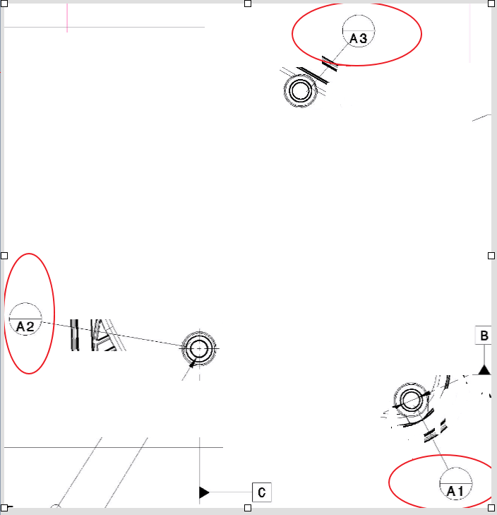

[Fr...] Posted September 27, 2022 Share Posted September 27, 2022 (edited) Is any possible to select muti planes as primary alignment and show it in report page as it on the drawing? Thanks for helping Edited September 27, 2022 Link to comment https://qualityforum.zeiss.com/topic/1420-select-multi-elements-on-alignment/ Share on other sites More sharing options...
[Na...] Posted October 5, 2022 Share Posted October 5, 2022 Hello Frank, you can create fitting plane from this selection if I understand this part of the drawing correctly. You could then create a report page with the point selection of the plane (right mouse button on the plane -> restore point selection and show CAD). In a datum system you can insert several planes as a common datum with shift+ctrl+left click. Regards, Nanno Link to comment https://qualityforum.zeiss.com/topic/1420-select-multi-elements-on-alignment/#findComment-4806 Share on other sites More sharing options...
