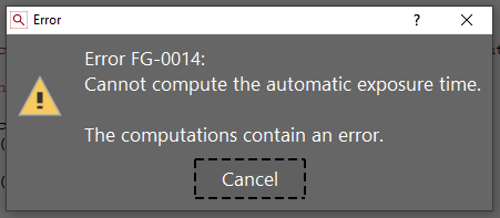

Case 2:
When using "Exposure Mode : Automatic by Matrix or Spot" via "Try & Expect method"
The script is stopping abruptly and showing a popup ERROR message.
As both error messages are same, then why one message is appearing in output box and other as popup Error message.

Case 2: -
import gom
try:
	gom.script.atos.set_parameters_for_new_measurements (automatic_exposure_time_mode='matrix')
	gom.interactive.atos.adjust_live_image_brightness ()
except Exception as error:
	print("Exposure Mode : Automatic by Matrix")
	print(error)
Case 2: - Output :
