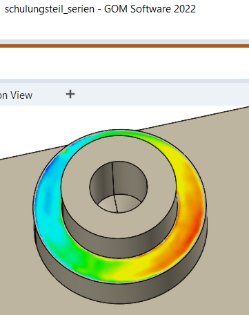

[Ti...] Posted October 2, 2022 Share Posted October 2, 2022 Using GD&T checks like flatness and surface profile you can usually just tab into the check and in the properties turn on 'color deviation'. I ran the same steps with 2021 and 2022 and cannot get the color deviation working in 2022. Anyone else have this issue? Link to comment https://qualityforum.zeiss.com/topic/1438-gom-2022-color-deviation-map-seems-to-be-missing/ Share on other sites More sharing options...
[Ch...] Posted October 4, 2022 Share Posted October 4, 2022 At least for a flatness tolerance I see the deviation plot as you can see in the following screenshot: Maybe the deviation plot is hide under the CAD or the mesh. Otherwise please contact your local GOM partner to get further support. Christoph Schult Link to comment https://qualityforum.zeiss.com/topic/1438-gom-2022-color-deviation-map-seems-to-be-missing/#findComment-4764 Share on other sites More sharing options...
[Ti...] Posted October 9, 2022 Author Share Posted October 9, 2022 Please sign in to view this username. I continued to have this problem until I reinstalled just now. The problem went away. I believe I reinstalled the same exact version, so I don't know why it fixed itself, but it is working now. I did nothing different, I'm familiar with how to show a flatness profile color map. It wasn't working for some reason. Link to comment https://qualityforum.zeiss.com/topic/1438-gom-2022-color-deviation-map-seems-to-be-missing/#findComment-4844 Share on other sites More sharing options...
