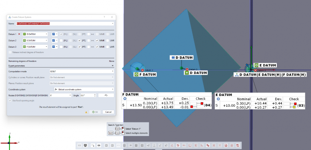

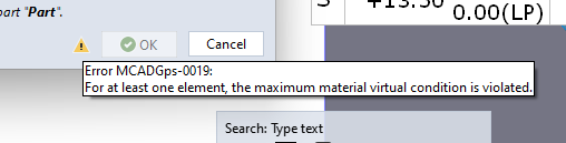

[La...] Posted October 4, 2022 Share Posted October 4, 2022 Hello, I want to create a datum system by activating MMC. However, I am getting the error in the picture below. Can you help with this problem? Link to comment https://qualityforum.zeiss.com/topic/1442-datum-system-error/ Share on other sites More sharing options...
[Na...] Posted October 4, 2022 Share Posted October 4, 2022 Hello Latif, it does not work for the reason stated in the dialog: the maximum virtual condition is violated (checks "S" on both circles). Regards, Nanno Link to comment https://qualityforum.zeiss.com/topic/1442-datum-system-error/#findComment-4778 Share on other sites More sharing options...
[Ja...] Posted October 4, 2022 Share Posted October 4, 2022 to aid the translation of this ..the datum fails at step 1 . if the element that it is based on fails then the datum cannot be created . the only way to get around the error is to increase the tolerance of the size to allow the mathematics to work . but of course you would need to understand the implication of doing so . Link to comment https://qualityforum.zeiss.com/topic/1442-datum-system-error/#findComment-4792 Share on other sites More sharing options...
[Ch...] Posted October 5, 2022 Share Posted October 5, 2022 The intended behavior if you have a datum system under material requirement with violated material condition is: 1) Creation of the datum system should be possible 2) Datum System remains uncomputed and delivers the displayed error. I assume the screenshot with disabled OK button is taken from the edit creation of the datum system. Please have a look into our tech guide, there is a page describing the technical backgrounds for datum system under material requirement: https://techguide.gom.com/en/gom-software-2021/article/general_mmr_background_information.html Hope this helps Christoph Schult Link to comment https://qualityforum.zeiss.com/topic/1442-datum-system-error/#findComment-4796 Share on other sites More sharing options...
