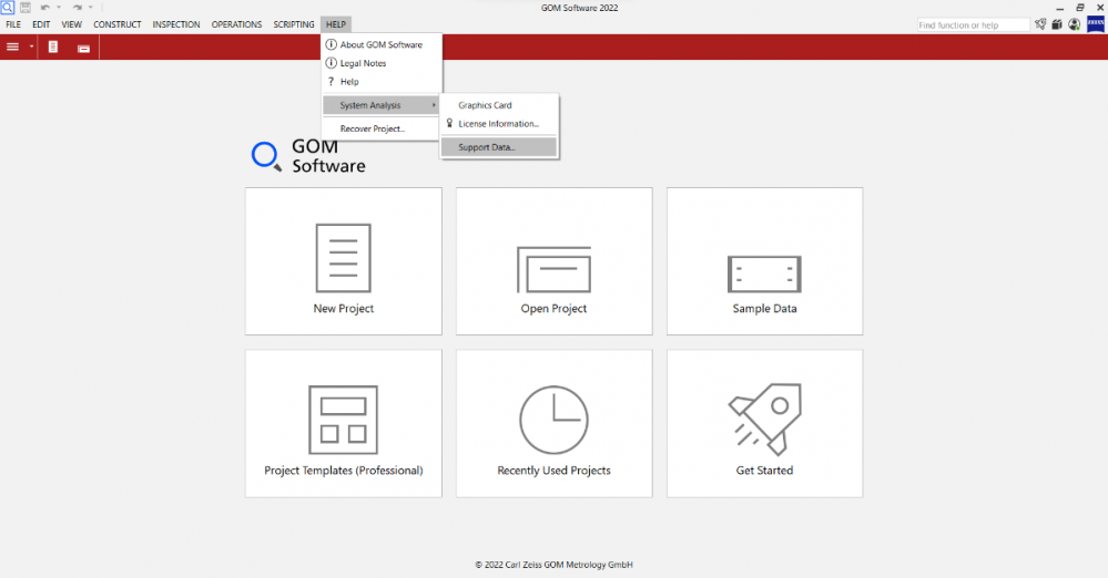

[MA...] Posted October 4, 2022 Share Posted October 4, 2022 I have encountered a problem with related GOM. I have been working correctly without any problems until a few days ago when suddenly the software crashed and showed an error message (attached). Now the software starts correctly but when I try to open any type of file ('new file', .ginspect, .gsnap) it crashes immediately showing the same error message. I have tried reinstalling the software but with no positive results.... What can I do? Thanks in advance Link to comment Share on other sites More sharing options...
[Iv...] Posted October 4, 2022 Share Posted October 4, 2022 Hello Mattia, which sw version do you currently use? Can you attach the mentioned support data? Greetings, Ivan Link to comment Share on other sites More sharing options...
[MA...] Posted October 4, 2022 Author Share Posted October 4, 2022 Gom 2022 version No, I can't. Because when I'm trying to generate that support file, the software crushes again... When the 'system information' window arrives at the end, the crush occur and that file can't be saved. Link to comment Share on other sites More sharing options...

[Iv...] Posted October 6, 2022 Share Posted October 6, 2022 Please collect the support data from the Zeiss Suite. Open the Suite. Open the slider Maintenance. Click on Collect Support Data. Please send the data to support@gom.com Link to comment Share on other sites More sharing options...
