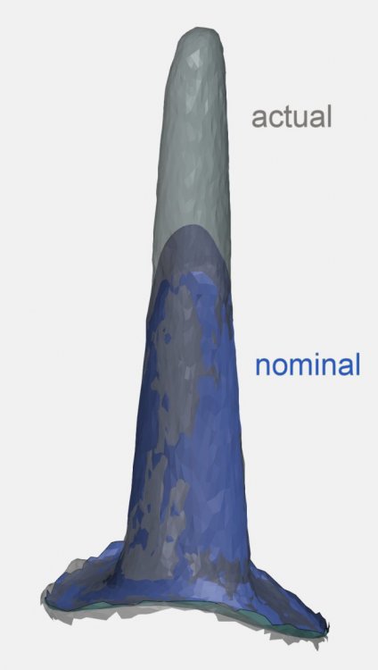

[Lu...] Posted April 4, 2021 Author Share Posted April 4, 2021 I am very happy with the solution! That's exactly what I'm looking for! And at the same time worried, as I cannot reproduce the solution given by Mr. Andreas and Mr. Nanno. And my time for presenting my dissertation is running out. I think it is asking a lot, but I have no choice but to ask for help with my work and request that these analyzes be done by you. I have been trying to reproduce this analysis for 3 days and I have not been successful. So I will leave the files here and if you can help me I will be extremely grateful. pin and man 6 mm.ginspect pin and man 8 mm.ginspect pin and man 12 mm.ginspect Link to comment Share on other sites More sharing options...

[An...] Posted April 5, 2021 Share Posted April 5, 2021 (edited) Hello Luciano, here are the evaluations of the three projects. In the project "pin and man 12mm.ginspect" the nominal data do not seem to match the actual data (see picture). Good luck with your dissertation! pin and man 6 mm NEW.ginspect pin and man 8 mm NEW.ginspect pin and man 12 mm NEW.ginspect Edited April 5, 2021 Link to comment Share on other sites More sharing options...
