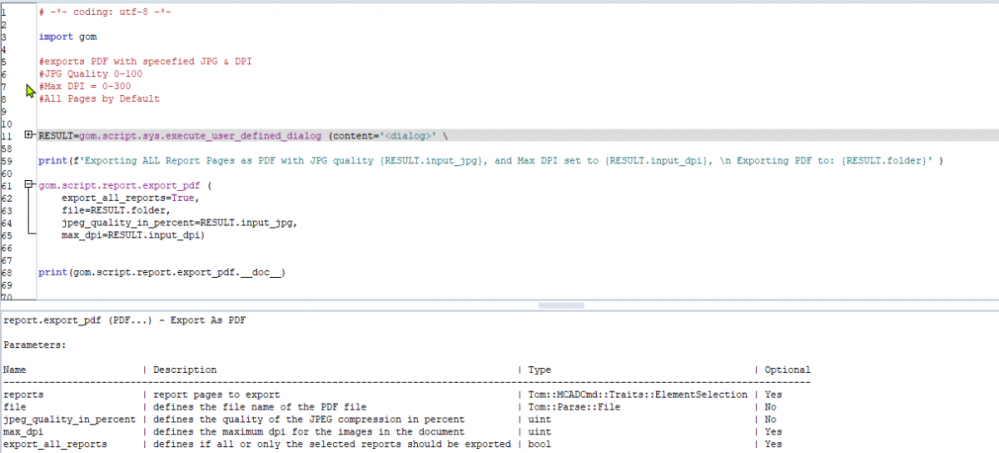

[ca...] Posted October 9, 2022 Share Posted October 9, 2022 Hello everyone, I have a project which includes four stages to recalculate. After calculating all inspection elements and report pages, i want to export .pdf for individual stages. However, script gives an error which says the command is not active. Same applies for the tables when try to export.But when i check, all inspection elements recalculated properly in different stages. What could be the reason of the problem ? Is the problem related with recalculation of different stages through script or command that i choose? The following command is not active: table.export_table_contents for a in range (0,len(mesh_checklist)): index=mesh_checklist[a].find(".g3d") gom.script.sys.show_stage (stage=gom.app.project.stages[mesh_checklist[a][:index]]) mesh=gom.app.project.parts['Part'].actual.import_information gom.script.report.export_pdf ( export_all_reports=True, file=filename+"_"+str(mesh.name)+'.pdf', jpeg_quality_in_percent=100) Link to comment https://qualityforum.zeiss.com/topic/1456-problem-with-exporting-report-pages-and-tables/ Share on other sites More sharing options...
[Jj...] Posted June 20, 2023 Share Posted June 20, 2023 Encountering a similar issue when trying to export pdf through a script. Specifically says this line " jpeg_quality_in_percent=100)" that is the reason for the unable to export pdf error. If anyone knows what could be the cause would be greatly appreciated. Link to comment https://qualityforum.zeiss.com/topic/1456-problem-with-exporting-report-pages-and-tables/#findComment-8043 Share on other sites More sharing options...
[De...] Posted June 22, 2023 Share Posted June 22, 2023 Please sign in to view this username. you can print the .__doc__ string for more information on the function I've also attached a screen grab of a script that exports PDF with 'custom' quality parameters. I think something with JPG Quality 97 & DPI of 275 works nice. Link to comment https://qualityforum.zeiss.com/topic/1456-problem-with-exporting-report-pages-and-tables/#findComment-8071 Share on other sites More sharing options...
