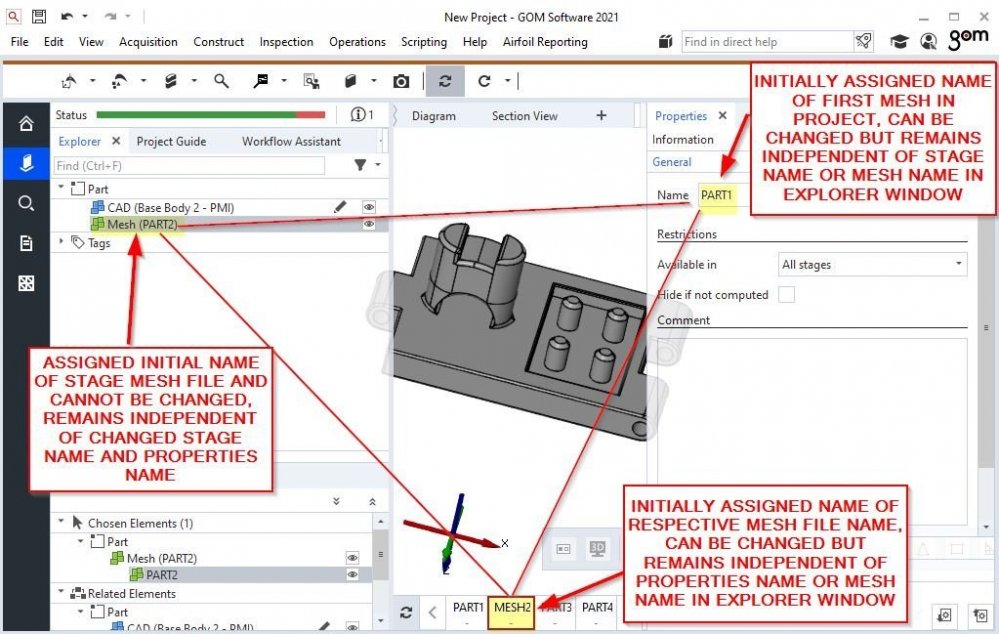

[Ji...] Posted October 10, 2022 Share Posted October 10, 2022 Hello, I found an issue that, in my workflow, doesn't seem right. The mesh name in the explorer window, the mesh name in the properties window, and the stage name are all independent (see attached image). Is this supposed to be like this? It makes no sense to me. Link to comment https://qualityforum.zeiss.com/topic/1464-mesh-explorer-namestage-nameproperties-name/ Share on other sites More sharing options...
[Be...] Posted October 11, 2022 Share Posted October 11, 2022 Hi, some basic explanations: Each object (in the explorer) has one unique name over all stages This means you can't decide the different stages of a mesh with an own name In the scripting engine you have an access via this name to the corresponding object. This name is usually displayed in the explorer and you can modify this name via the properties tab. If you have a project with only one stage (stage explorer is usually invisible for one stage) you can try this and the name in the explorer and in the properties tab is identical. Each stage is also represented within a special explorer (timeline) and has also a unique name. During the import of a mesh we copy the name of the imported file as stage name to have a better distinction between the different stages. Keep in mind: the name of the mesh object does NOT change But now it's getting a little bit weird: If you have a stage project (with more than one stage) the the explorer does not show anymore the name of the current mesh object. For the CAD or all other objects the object name is also shown in the explorer. The name of the object is still modifiable and the properties tab shows the "correct" object name. In the moment we are investigating why we show in the explorer a different name for the actual portion of the part (only in stage projects). If we have more information why this behavior was introduced I give you some more explanations on that. Regards, Bernd Link to comment https://qualityforum.zeiss.com/topic/1464-mesh-explorer-namestage-nameproperties-name/#findComment-4886 Share on other sites More sharing options...
[Be...] Posted October 12, 2022 Share Posted October 12, 2022 Hi, some additional information which clarifies the current behavior: If we have enabled the timeline (due to stages) we show the imported name of the mesh in the explorer, for each stage this could be a different name. If this information is not available we show the unique object name. This means unfortunately also: You can't change the name in the explorer for display purposes, it's always the imported name. Of course you can change the unique object name or the independent stage name but we gave you no possibility to change the imported stage name. Hope this clarifies the observed behavior?! Regards, Bernd Link to comment https://qualityforum.zeiss.com/topic/1464-mesh-explorer-namestage-nameproperties-name/#findComment-4894 Share on other sites More sharing options...
[Ji...] Posted October 17, 2022 Author Share Posted October 17, 2022 No, this behavior makes no sense to me based on our workflow. If you want to change the name of the active mesh (stage) in the explorer window, you can't. You are stuck with the initial mesh name that was imported with. That does not seem very user friendly. The explorer mesh name, the stage name, and the properties name should all be linked. Link to comment https://qualityforum.zeiss.com/topic/1464-mesh-explorer-namestage-nameproperties-name/#findComment-4932 Share on other sites More sharing options...
[Be...] Posted October 18, 2022 Share Posted October 18, 2022 I have recorded your wish but we can't ensure if or when we would realize this issue. Regards Link to comment https://qualityforum.zeiss.com/topic/1464-mesh-explorer-namestage-nameproperties-name/#findComment-4936 Share on other sites More sharing options...
