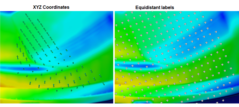

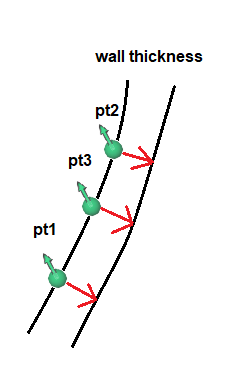

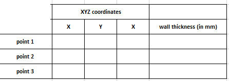

[be...] Posted October 26, 2022 Share Posted October 26, 2022 (edited) Hello, Is it possible, after a thickness inspection, to export spreadsheets of a points cloud that contains either the XYZ coordinates, and the direct wall thickness for each point ? Like this template: i can export a cloud whith XYZ points or a cloud of equidistant labels with the thickness, but I don't know how to correlate the datas. Edited October 26, 2022 Link to comment https://qualityforum.zeiss.com/topic/1508-export-a-spreadsheet-that-correlates-xyz-coordinates-and-thickness-dimensions/ Share on other sites More sharing options...

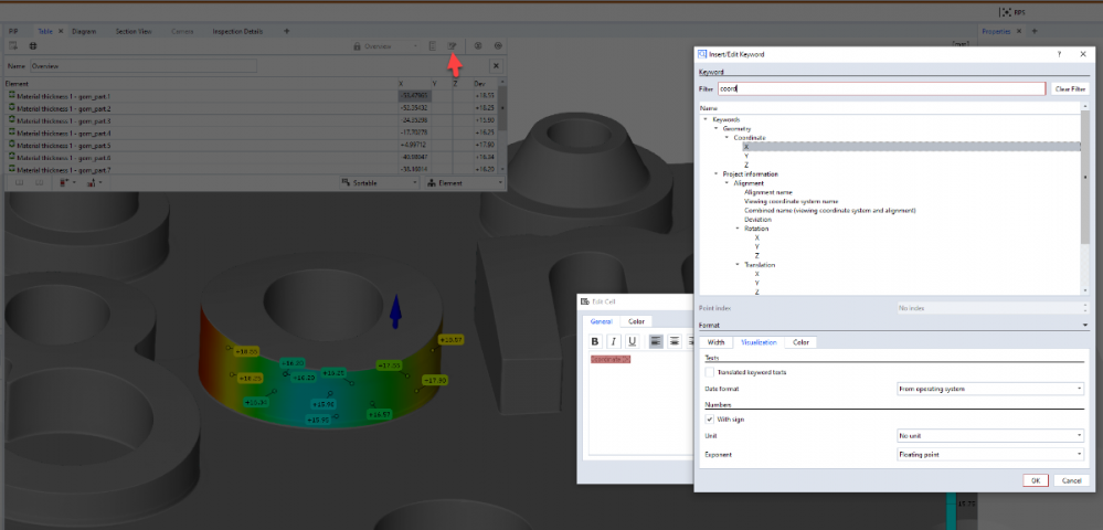

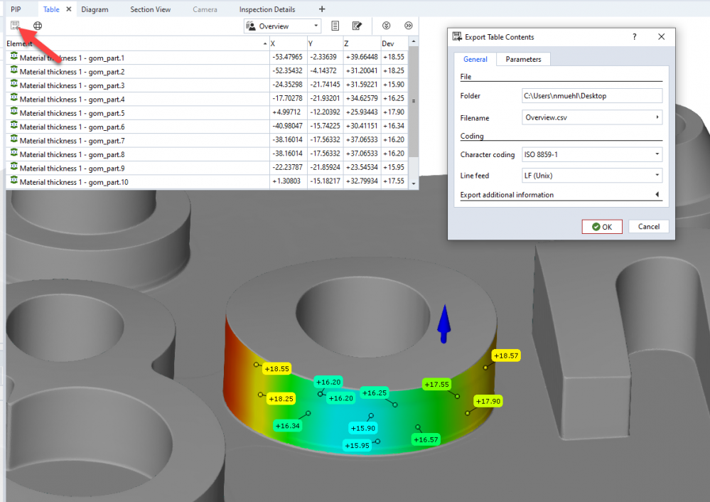

[Na...] Posted November 8, 2022 Share Posted November 8, 2022 Hello Benjamin, one solution is to edit the table to show X,Y,Z coordinates. The table values can be exported directly as .csv: We also have this element, which can be applied to existing points: https://techguide.gom.com/en/gom-software-2022/article/cmd_inspection_check_material_thickness_at_points.html It is also possible to select the material thickness and export it as ASCII: https://techguide.gom.com/en/gom-software-2022/article/cmd_sys_export_ascii.html This will export every point of the colored mesh with X/Y/Z coordinates and the material thickness. Regards, Nanno Link to comment https://qualityforum.zeiss.com/topic/1508-export-a-spreadsheet-that-correlates-xyz-coordinates-and-thickness-dimensions/#findComment-5174 Share on other sites More sharing options...
