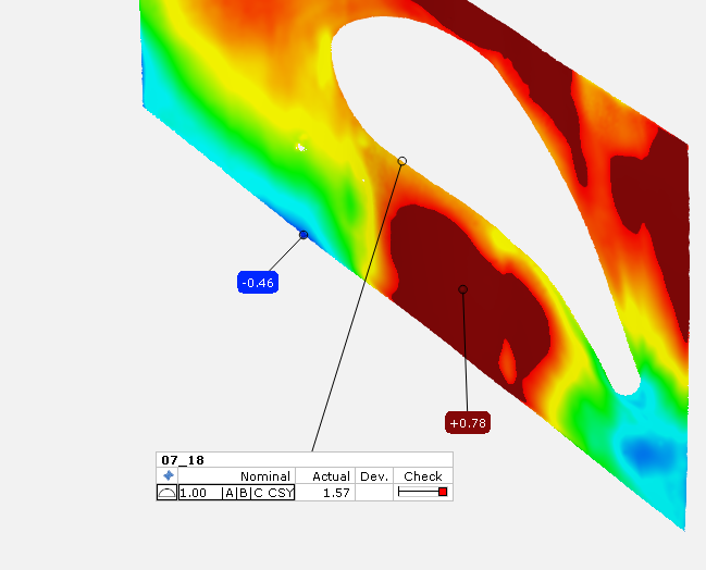

[Ja...] Posted April 6, 2021 Share Posted April 6, 2021 I've screenshotted an image showing the upper and lower areas on my surface, but they don't appear to link to my Actual? What is driving the Actual result? Link to comment Share on other sites More sharing options...
[Na...] Posted April 8, 2021 Share Posted April 8, 2021 Hello Jack, for the surface profile virtual spheres are placed on the nominal surface, with their center point on the nominal surface. The deviation of +0.78 is the distance from the actual data to the nominal at this spot. A GD&T check returns the "worst" result - in this case you would need a sphere with a diameter of 1.57 to find the actual data inside the tolerance zone (1.57 ~= 2*0.78, should be clearer with more digits). There are some pictures in the direct help for the surface profile to illustrate this. Regards, Nanno Link to comment Share on other sites More sharing options...
