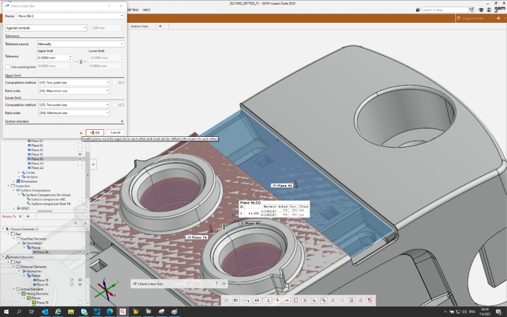

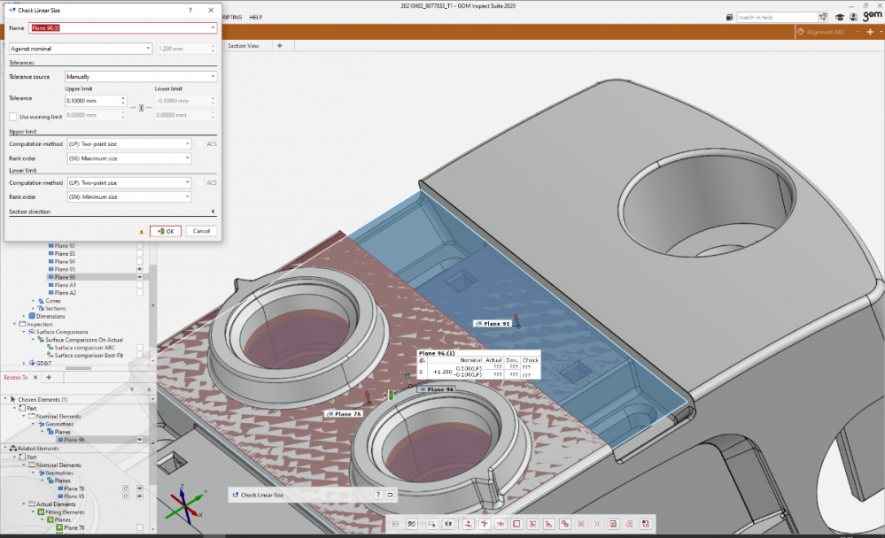

[Ge...] Posted April 7, 2021 Share Posted April 7, 2021 Hello colleagues, I want to check distance between 2 planes(the depth between them), but when I make them, GOM said that the planes must be opposite each other. When the planes are opposite the function (independency principle) works, but when they are with same direction(example +Z) not. I want to know if there is a way to check those distances the minimum and maximum between two planes? See the pictures. Thank you in advance colleagues! Link to comment https://qualityforum.zeiss.com/topic/153-distancedepth-between-2-parallel-planes-with-same-direction/ Share on other sites More sharing options...
[Ch...] Posted April 8, 2021 Share Posted April 8, 2021 Hello, an evaluate size evaluation is only possible if the inspected distance is a linear size according to ISO 14405-1. This is not the case if the used planes do not lie opposite to each other. To make things worse it is complete unclear what the distance you like to inspect in such a case. Therefore we can not provide a out of the box solution for such a case. Instead you have to define your own measuring strategy. More explanation can be found in our software direct help (The document is named "General Information on Size and Distance Dimensions") starting with GOM software 2020. This document also explained the GD&T based approach to solve this problem; as well as the classic two point distance approach. Of course, if these solutions do not fulfill you needs you can define your own strategy (e.g. using deviation to primitive). Hope this helps Christoph Schult Link to comment https://qualityforum.zeiss.com/topic/153-distancedepth-between-2-parallel-planes-with-same-direction/#findComment-440 Share on other sites More sharing options...

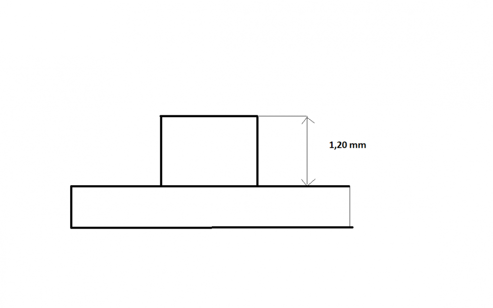

[Ge...] Posted April 8, 2021 Author Share Posted April 8, 2021 Please sign in to view this quote. Hello Mr. Schult, thank you very much for the reply, but unfortunately I could not find a solution in the manual guide, I have searched in it before write at the forum. I will be more specific - I have two parallel planes, which directions are in (+Z) see picture 1 above. The distance in drawing between them is 1,20mm. I want to check the minimal two point distance and the maximal two point distance between these parallel planes(picture 2 and picture 3 above), not middle surface points. I think this is very standard situation to check the depth between 2 parallel planes with same direction(see Example.png), and the software could calculate 3 values - LP min(minimal two point size), LP max(maximal two point size) and middle size between two planes, but I do not know how? Link to comment https://qualityforum.zeiss.com/topic/153-distancedepth-between-2-parallel-planes-with-same-direction/#findComment-442 Share on other sites More sharing options...
[Ch...] Posted April 8, 2021 Share Posted April 8, 2021 Hello, as I mentioned before this distance check is not unambiguous. Obviously you cannot project all points from the lower mesh area on the higher mesh area. Therefore you have to define what you want instead. Some possible approaches that are possible: a) Project all points from the upper area to a fitting plane estimated from the lower area (then the question is what fitting algorithm you will using to estimate the primitive plane) using the plane normal as projection direction b) Project all points from the lower area to fitting plane estimated from the upper area using the plane normal as projection direction (the question of the fitting algorithm is the same as in (a) c) Estimate two parallel planes with variable distance from the current selection (Question again: What is the correct fitting approach). Project each point from both area on the opposite plane. d) ... Some of this approaches are possible in the software using fitting elements and the function "deviation to geometry". Afterwards you could evaluate this deviation plot to find the minimum or maximum point. But nevertheless the ISO does not recommend such approach (see ISO 14405-2), instead you should use a clear inspection task using GD&T language, i.e. surface profiles or positioning tolerancing. In case of further question please contact your local GOM partner to get further support. Hope this helps Christoph Schult Link to comment https://qualityforum.zeiss.com/topic/153-distancedepth-between-2-parallel-planes-with-same-direction/#findComment-443 Share on other sites More sharing options...
[Ch...] Posted April 15, 2021 Share Posted April 15, 2021 Here is a FAQ article showing different options to create distances between planes and its unambiguousity: https://connect.gom.com/x/jJ7VAg Link to comment https://qualityforum.zeiss.com/topic/153-distancedepth-between-2-parallel-planes-with-same-direction/#findComment-481 Share on other sites More sharing options...

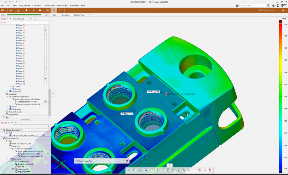

[Jo...] Posted July 22, 2022 Share Posted July 22, 2022 During the basic starter tutorial on GOM website, they share the 'independency principle' method to get a min/max distance between two planes. As we, know planes can be weird to get proper distances from, but in their tutorial it is quite simple. It also works for me 80% of the time, but for some reason 20% of the time I get ????? or no scalar data or the planes are parallel errors. Anyone else notice this? I think it happens when a surface area isn't very large to make a nice plane. I'd like to share the file but cannot in this case. Link to comment https://qualityforum.zeiss.com/topic/153-distancedepth-between-2-parallel-planes-with-same-direction/#findComment-3883 Share on other sites More sharing options...
[Ch...] Posted July 25, 2022 Share Posted July 25, 2022 Please check if the requirements at mentioned in the techquide are fullfilled Please sign in to view this quote. see here: https://techguide.gom.com/en/gom-software-2021/article/general_project_guide_length_information.html Of course the error message can also appears for very small planes but in general the problem lies in not fullfilled requirements as mentioned in the techguide article. Link to comment https://qualityforum.zeiss.com/topic/153-distancedepth-between-2-parallel-planes-with-same-direction/#findComment-3889 Share on other sites More sharing options...

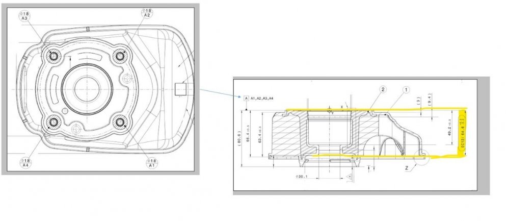

[Ru...] Posted April 1, 2025 Share Posted April 1, 2025 Hello I raise this topic again because i have the same problem an i cannot find a solution into tech guide or into the forum I have two parallel planes (in theory at least for nominal CAD) but i want to measure the max / min distance between them in meshed part . I tried it i using Independence principle or envelope principle and appears the message that "no scalar data or the planes are parallel" errors. This cannot be so difficult because its common check several times , and the evaluation point to point evaluation is not accurate Also One of the planes , the upper one i must create it based in four areas selection Link to comment https://qualityforum.zeiss.com/topic/153-distancedepth-between-2-parallel-planes-with-same-direction/#findComment-129357 Share on other sites More sharing options...

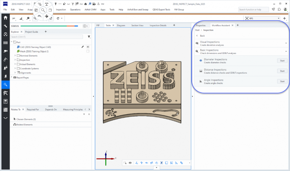

[Na...] Posted April 1, 2025 Share Posted April 1, 2025 Hello Ruben, different methods are described in this article (it's an updated version of the link in a post above): https://techguide.zeiss.com/en/zeiss-inspect-2025/article/faq_how_to_evaluate_the_distance_between_planes.html The independency principle only works for opposite planes as defined by the standard. Maybe the method "deviation to geometry" would be a solution for your inspection task or a position check with GD&T and min/max labels. In general, the Workflow Assistant was added to the inspection workspace with Inspect 2025. It will guide the user through different checks like distances or angles. Needed elements can be constructed directly from inside the dialog. Link to comment https://qualityforum.zeiss.com/topic/153-distancedepth-between-2-parallel-planes-with-same-direction/#findComment-129383 Share on other sites More sharing options...
