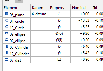

[Ge...] Posted November 4, 2022 Share Posted November 4, 2022 If I sort a table by the Element column it seems to sort first by type, then by name. Is there a way to sort only by name? See screenshot. 06_plane is listed before 01_circle Link to comment https://qualityforum.zeiss.com/topic/1536-sort-table-by-element-name-only/ Share on other sites More sharing options...
[Da...] Posted November 4, 2022 Share Posted November 4, 2022 (edited) You could insert a new coloum and enter the keyword 'name' when editing the cell content. Edited November 4, 2022 Link to comment https://qualityforum.zeiss.com/topic/1536-sort-table-by-element-name-only/#findComment-5134 Share on other sites More sharing options...
