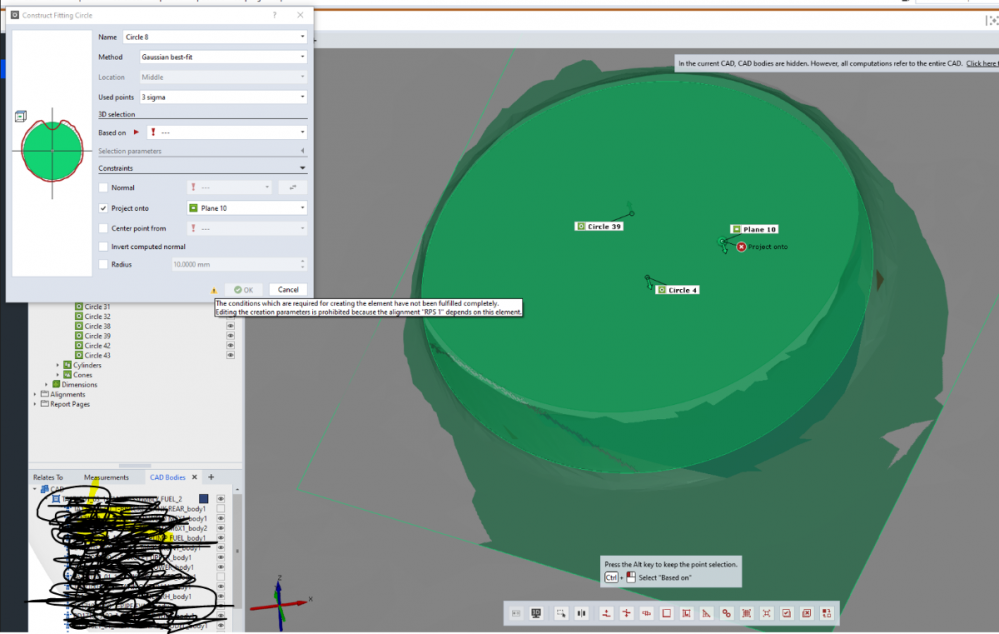

[Di...] Posted November 7, 2022 Share Posted November 7, 2022 (edited) Dear Community, I have done alignment for scanned STL file and CAD file and generated report, Now I want to replace this STL file with new STL file and do the alignment but alignment circles drawn for alignment of previous STL file gets deviated while replacing and can not be edited. While this editing was possible in GOM Inspect V7.5 but not in GOM 2021. How can I edit previously drawn alignment circles? Edited November 7, 2022 Changes in media Link to comment https://qualityforum.zeiss.com/topic/1542-editing-alignment-circle-in-gom-inspect-2021/ Share on other sites More sharing options...
[Be...] Posted November 7, 2022 Share Posted November 7, 2022 Hi, usually fitting elements (also some other elements) got a so called Required alignment flag. This flag indicates that this element is only computed once in the alignment which you can define. If such an element is used for computing a depending alignment (e.g. in your case the RPS alignment) this element could not be edited during this alignment is active. Otherwise we would get a circular dependency which would lead to infinite looping. Simply switch into the computation alignment of the fitting circle and edit the element. Regards, Bernd Link to comment https://qualityforum.zeiss.com/topic/1542-editing-alignment-circle-in-gom-inspect-2021/#findComment-5152 Share on other sites More sharing options...
