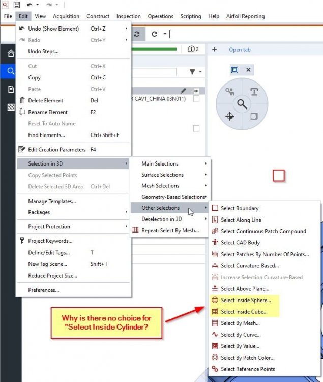

[Ji...] Posted November 7, 2022 Share Posted November 7, 2022 Hello, I have come across some applications where I need to select parts of a mesh using "Select Inside Cylinder", similar to "Select Inside Sphere" or "Select Inside Cube" Why isn't there a choice for this option? Link to comment https://qualityforum.zeiss.com/topic/1544-selection-in-3d-select-inside-cylinder/ Share on other sites More sharing options...
[Ch...] Posted November 8, 2022 Share Posted November 8, 2022 Hello, use "Select by Geometric Contour" instead. Yes, we are knowing that the option is well hidden but this selection command is capable of select inside a cylinder Yes, we have to do something that this option is better visible, but it should solve your problem. Christoph Schult Link to comment https://qualityforum.zeiss.com/topic/1544-selection-in-3d-select-inside-cylinder/#findComment-5160 Share on other sites More sharing options...
[Ji...] Posted November 8, 2022 Author Share Posted November 8, 2022 Thanks for the reply. Can you put a customer request in to the developers to add a "Select Inside Cylinder" option to the "Other Selections" menu to make the software easier to use? Link to comment https://qualityforum.zeiss.com/topic/1544-selection-in-3d-select-inside-cylinder/#findComment-5170 Share on other sites More sharing options...
