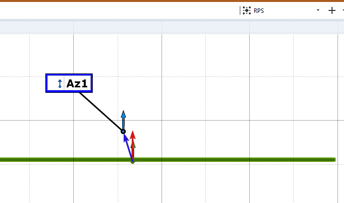

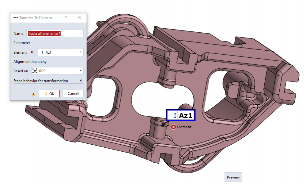

[Ma...] Posted November 8, 2022 Share Posted November 8, 2022 Good morning, is there an alternative to the alignment called "Translate to element" to shift the mesh only in the direction of the point? Translate to element works perfectly if I use a surface point in the CAD and I measure it with intersection with mesh, but if I measure the point by, for example, disc caliper or edge caliper the translate to element add to my parent alignment X or Y component when I want to use it only for the Z, for example. In the image I show what I want: use the point only in the red direction and not in the blue direction. is it possible? Thank you in advance! Link to comment https://qualityforum.zeiss.com/topic/1548-alignment-translate-to-element/ Share on other sites More sharing options...
[Be...] Posted November 8, 2022 Share Posted November 8, 2022 Hi, simple answer: Yes, it is possible. Use a RPS alignment where you constrain the degrees of freedom (only one translation to a specific coordinate system which represents the direction of translation) and you insert only the nominal point element as observation. Hope this helps?! Regards, Bernd Link to comment https://qualityforum.zeiss.com/topic/1548-alignment-translate-to-element/#findComment-5166 Share on other sites More sharing options...
[Ma...] Posted January 5, 2023 Author Share Posted January 5, 2023 Okay, after all this time I was finally able to test the solution you posted and it works very well. Thank you so much! Link to comment https://qualityforum.zeiss.com/topic/1548-alignment-translate-to-element/#findComment-5611 Share on other sites More sharing options...
