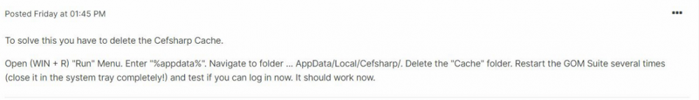

[J....] Posted November 15, 2022 Share Posted November 15, 2022 Hi All, When click on Training, store or Tech guide in the Zeiss quality suite i'm getting the following error. Also login doesn't work ? Bad Request - Request Too Long HTTP Error 400. The size of the request headers is too long. Link to comment https://qualityforum.zeiss.com/topic/1564-zeiss-quality-suite-login-problems/ Share on other sites More sharing options...
[Ch...] Posted November 15, 2022 Share Posted November 15, 2022 Please try to restart the Zeiss Quality Suite - there is a restart button in the settings (wheel). This might already help. Is it possible to access training.gom.com or techguide.gom.com via an internet explorer? Link to comment https://qualityforum.zeiss.com/topic/1564-zeiss-quality-suite-login-problems/#findComment-5218 Share on other sites More sharing options...
[J....] Posted November 16, 2022 Author Share Posted November 16, 2022 Still the same error ! Link to comment https://qualityforum.zeiss.com/topic/1564-zeiss-quality-suite-login-problems/#findComment-5220 Share on other sites More sharing options...
[Fa...] Posted November 16, 2022 Share Posted November 16, 2022 Hi, I had that same problem, Try this and see if it helps. Link to comment https://qualityforum.zeiss.com/topic/1564-zeiss-quality-suite-login-problems/#findComment-5222 Share on other sites More sharing options...
[15...] Posted November 16, 2022 Share Posted November 16, 2022 As Fariborz posted, delete the Cefsharp Cache. Afterwards it should work again. Best regards, Matthias Link to comment https://qualityforum.zeiss.com/topic/1564-zeiss-quality-suite-login-problems/#findComment-5224 Share on other sites More sharing options...
[J....] Posted November 17, 2022 Author Share Posted November 17, 2022 It worked, THX Link to comment https://qualityforum.zeiss.com/topic/1564-zeiss-quality-suite-login-problems/#findComment-5234 Share on other sites More sharing options...
