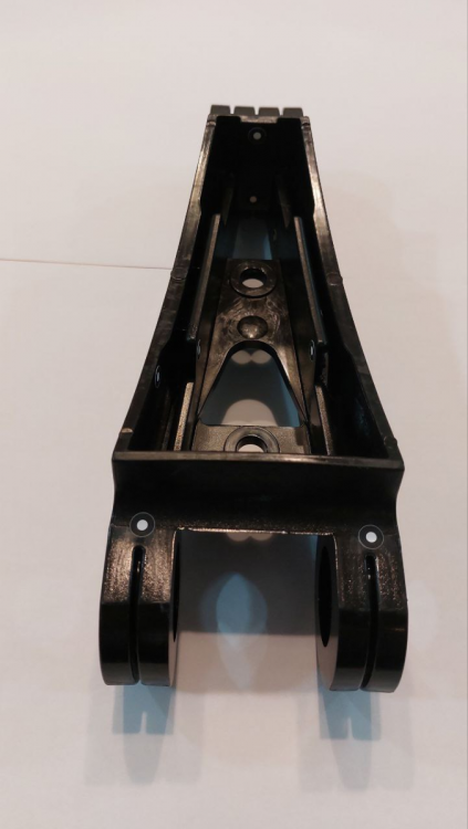

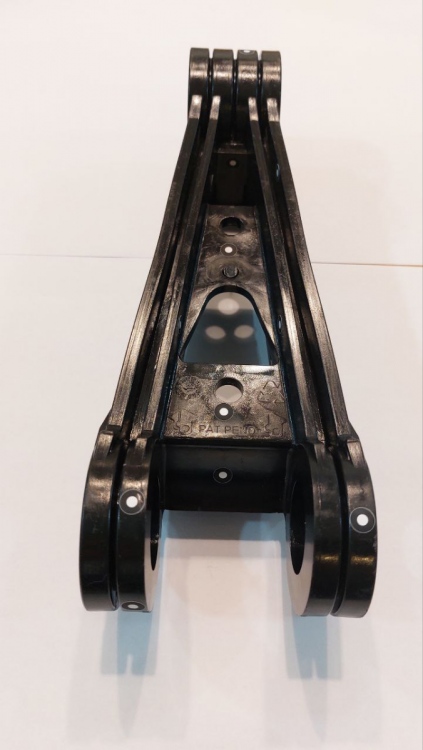

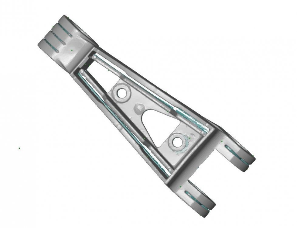

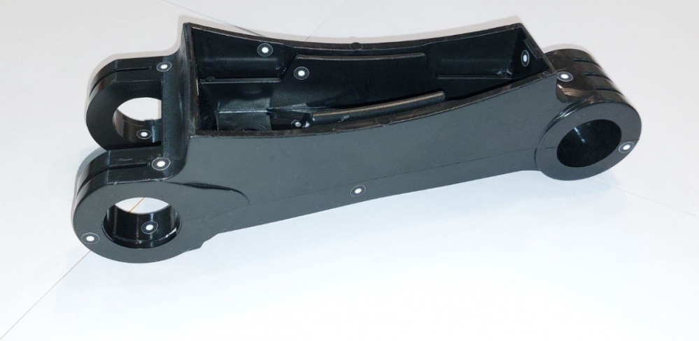

[Im...] Posted November 22, 2022 Share Posted November 22, 2022 Hello Members , I have a plastic parts with deep pockets feature to be scanned ( You can check the parts pictures below ). I know there is options to scan deep pockets features utilizing GOM Software Can anyone suggest or guide me how to approach to scan the parts especially the deep pocket region ( With what setting & tweaks we need to do in software to scan those features ) I tried using multiple scans got the overall good result but in case of deep pockets, its not upto the mark. Kindly share your experience in this regards ( If you can share with any examples or snapshots it would be really helpful ) I am using ATOS 5 with GOM Software 2021 Thanks in advance Link to comment https://qualityforum.zeiss.com/topic/1577-scanning-deep-pockets-based-plastic-parts-using-atos-5-scanner-gom-software-2021/ Share on other sites More sharing options...
[Ja...] Posted November 22, 2022 Share Posted November 22, 2022 I think maybe there is some confusion , the 'deep pockets' terminology i associate with the t-scan hawk harware , nota software function. Looking at the pictures this could be very challenging to get everything. There are multiple factors at play here Line of sight - aspect ratio makes it tricky to get visual access Angle onto walls shallow - there is a limit. Could attempt to allow long triangles in scanning settings Part is dark and shiny - this in combination with shallow angle makes life very difficult. More exposure times and ' more points' option might help, otherwise digitising spray Beyond this i think youll need some direct help from your distributor , so they can work with you to confirm the limits. Link to comment https://qualityforum.zeiss.com/topic/1577-scanning-deep-pockets-based-plastic-parts-using-atos-5-scanner-gom-software-2021/#findComment-5253 Share on other sites More sharing options...
[Im...] Posted November 22, 2022 Author Share Posted November 22, 2022 Please sign in to view this quote. Dear James, Thanks for the reply , i really appreciate your response. I am very much aware about deep pockets association with particular t-scan hawk hardware. What i meant here by deep pockets is about deep depth features in particularly , there are certain ways using single camera we can scan particular area with better scanning details . Since ATOS 5 have triple scan functionality i think it could be done , obviously not full scan but as you know much more scanned portion much more better it will be to reverse engineered. I want to know how to approach those setting so that it can be done in better ways. There are so many member in this forum who must had tried those setting or may be have face similar challenge . I am also looking forward for GOM experts response ,what they had to suggest . Regards Link to comment https://qualityforum.zeiss.com/topic/1577-scanning-deep-pockets-based-plastic-parts-using-atos-5-scanner-gom-software-2021/#findComment-5255 Share on other sites More sharing options...
[Ch...] Posted November 22, 2022 Share Posted November 22, 2022 Another option when spray is not relevant - is to try out the "reflection detection" (this functionality is more for automated/scanbox applications) but it can be applied in a manual way as well. Link to comment https://qualityforum.zeiss.com/topic/1577-scanning-deep-pockets-based-plastic-parts-using-atos-5-scanner-gom-software-2021/#findComment-5259 Share on other sites More sharing options...
[No...] Posted November 22, 2022 Share Posted November 22, 2022 We scan a lot of parts like this, but never without spraying. We use an ATOS Capsule with two different MVs and find it next to imposiible to scan something like this (black and shiny) without spraying. And I'm talking about the part as a whole here, not just deep pockets. Maybe newer scanners are somehow better in this respect (though I can't imagine how)? In my experience deep pockets scan better with a smaller MV. Although the distance between camera(s) and projector basically stays the same, smaller MVs seem to work a bit better. You should use a rotary table and try to scan the pocket so that both cameras have the widest possible viewing angle as often as possible. Also make both camera images visible and try to find a part position where the area to be scanned is visible in both images. That gives you the best chances to get as much data as possible. By the way, a thing you probably won't be able to prevent: The narrower a deep pocket gets, the more you'll experience an "orange-peel" effect on the surfaces scanned. This seems to be related to light reflected by the pocket walls and seemingly can't be avoided. Link to comment https://qualityforum.zeiss.com/topic/1577-scanning-deep-pockets-based-plastic-parts-using-atos-5-scanner-gom-software-2021/#findComment-5261 Share on other sites More sharing options...

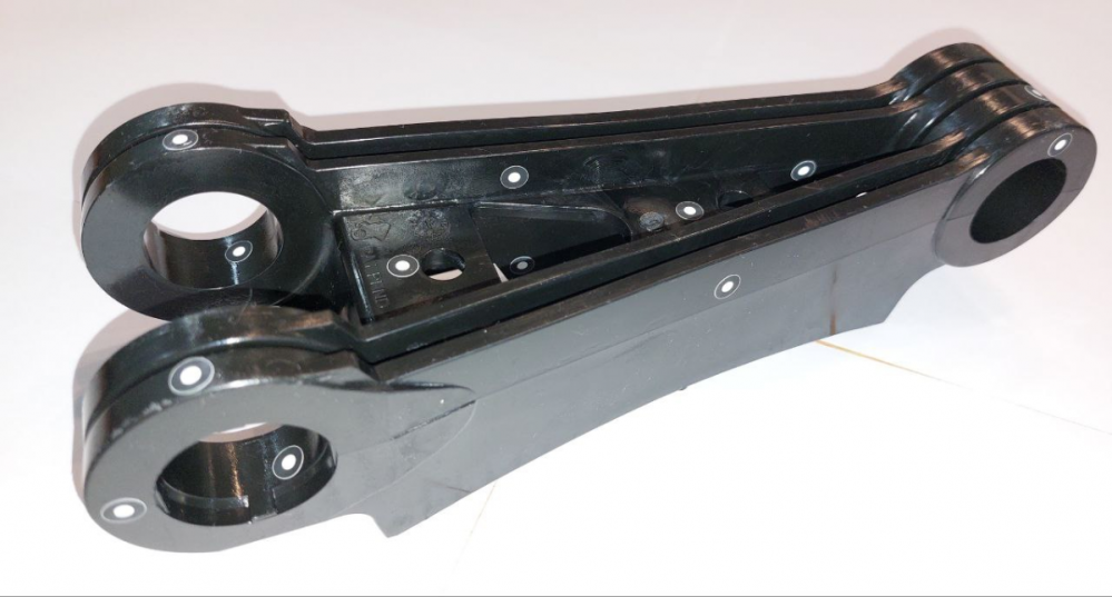

[Im...] Posted November 24, 2022 Author Share Posted November 24, 2022 Please sign in to view this quote. Dear Please sign in to view this username. Thanks for the response, definitely i will use scanning spray . FYI i just shared the pictures without spray for better viewing so that people can can see the deep pockets . I will give a try with reflection detection (manually method ) Regards Link to comment https://qualityforum.zeiss.com/topic/1577-scanning-deep-pockets-based-plastic-parts-using-atos-5-scanner-gom-software-2021/#findComment-5269 Share on other sites More sharing options...

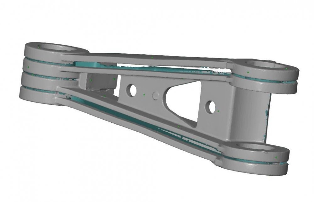

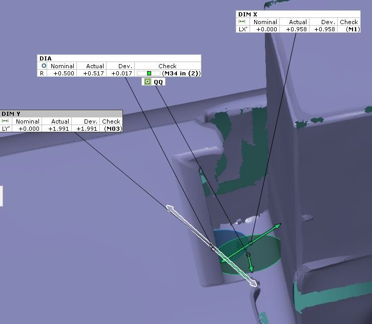

[Im...] Posted November 24, 2022 Author Share Posted November 24, 2022 Please sign in to view this quote. Dear Please sign in to view this username. Thanks for the response, really appreciate . As I mentioned in above comments definitely i will use scanning spray . FYI i just shared the pictures without spray for better viewing so that people can can see the deep pockets . Regarding the smaller MV ( We have 170 & 320 let me try with that & i will get back to you ) Till now tried with bigger lenses of MV 700 & result is not upto mark( As u can see in the attached snaps below ) The deep features details is needed to make accurate RE parts especially the rib & others Regards Link to comment https://qualityforum.zeiss.com/topic/1577-scanning-deep-pockets-based-plastic-parts-using-atos-5-scanner-gom-software-2021/#findComment-5271 Share on other sites More sharing options...

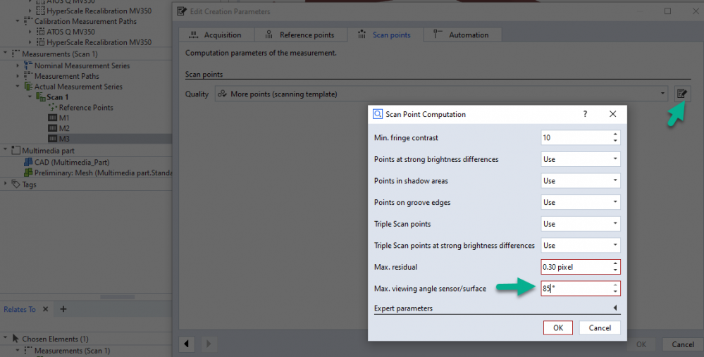

[Na...] Posted November 25, 2022 Share Posted November 25, 2022 Hello Imran, it looks like the sensor is able to scan the surface. Even in the pockets is some scan data. Did you try to align the channel with both cameras? The view from the sensor's position would look like on your last screenshot. Then tilt the sensor a bit, so it is not looking perpendicular on the plane inside the channels. Maybe you can get some more data when you edit the creation parameters of the measurement -> Scan points -> Quality and increase the max. angle Sensor/Surface to 85°. Regards, Nanno Link to comment https://qualityforum.zeiss.com/topic/1577-scanning-deep-pockets-based-plastic-parts-using-atos-5-scanner-gom-software-2021/#findComment-5301 Share on other sites More sharing options...
[Ja...] Posted November 26, 2022 Share Posted November 26, 2022 Hey imran, Glad response was useful, i think everyone is giving much the same advise here. No one likes using spray and you can use it less these days but there are times when it cant be avoided. what i would say is that switching lenses is not going to help much here . Hard to see scale but looking at result at the moment mv700 seems appropriate for level of detail. smaller lenses do not improve the line of sight and by definition have shorter depth of field which doesnt help for deep pockets. i would say you should be able to get the plane of the bottom of the channel with the right angle, but no chance youll get the wall base plane radius transition. I have a lot of experience with the systems and parts like this are definitely amongst hardest to approach for maximising coverage efficiently P.s. Thanks Nanno , the ' long triangles' i mentioned is relating to the max viewing length. Link to comment https://qualityforum.zeiss.com/topic/1577-scanning-deep-pockets-based-plastic-parts-using-atos-5-scanner-gom-software-2021/#findComment-5313 Share on other sites More sharing options...
