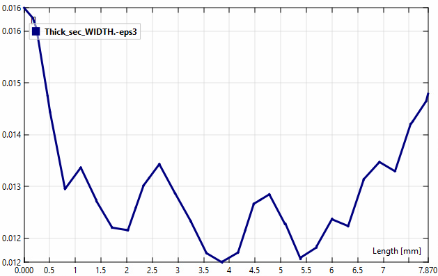

[An...] Posted April 12, 2021 Share Posted April 12, 2021 Hello wise men, I'm trying to plot a true stress on a tentsile test. For that I create a section in width direction and I manage to plot the thickness reduction at each step. Can anyone guide me how to read into a script the data of thickness reduction curve, so I could calculate the area of the specimen at each step? Or maybe there is a better way to do it? Any help or suggestion is welcomed. Thank you! Andrus Link to comment https://qualityforum.zeiss.com/topic/161-how-to-read-in-thickness-reduction-value-in-each-step/ Share on other sites More sharing options...

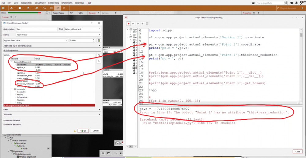

[Na...] Posted April 14, 2021 Share Posted April 14, 2021 Hello Andrus, is a user defined check on the thickness a solution for you? You can access the values of your check and do calculations with them. Regards, Nanno Link to comment https://qualityforum.zeiss.com/topic/161-how-to-read-in-thickness-reduction-value-in-each-step/#findComment-470 Share on other sites More sharing options...
[Mi...] Posted March 7, 2023 Share Posted March 7, 2023 Dear Nanno, This could be a solution. We have defined user element 'Point 1' that displays thickness reduction (as an example). But how could we access this value in user defined script? Below is a screenshot with an error message. Note that we can access the coordinate information of the specific point, but not the thickness_reduction what we actually need. Is there a way to query what these containers actually include, e.g. what is contained in gom.app.project.actual_elements['Point 1'] - all the objects inside this? Best Mihkel & Andrus Link to comment https://qualityforum.zeiss.com/topic/161-how-to-read-in-thickness-reduction-value-in-each-step/#findComment-7115 Share on other sites More sharing options...
