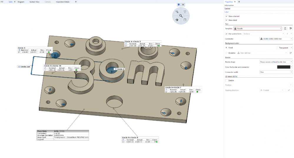

I would like to make a summary page in my project.
On this summary page I would like to show a table with:
  • Total number of measurements
  • Number of out of spec.
I can I do this?
Should I make a group of the elements and then with a user defined inspection this value can be found?
Johnny
You could create a label with Inspection -> Create Annotation. There is a label template "Results" for this, which will show a pass rate of the visible elements. There are also keywords for elements inside the tolerance, which can be placed on a report page. Make sure to place a 3D-placeholder on the report page with every element on the report page, since the keyword will only consider visible elements.
