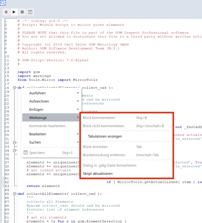

[An...] Posted January 2, 2023 Share Posted January 2, 2023 Hallo und ein gutes neues Jahr 2023 an alle hier im Forum! Hello and a happy new year 2023 to everyone here on the forum! In GOM Inspect 2021 gibt es im Skripteditor sogenannte "Unterbrechungspunkte": In GOM Inspect 2021 there are so-called "break points" in the script editor: In GOM Inspect 2022 scheint es diese hingegen nicht mehr zu geben: In GOM Inspect 2022, however, these no longer seem to exist: Gibt es diese "Unterbrechungspunkte nicht mehr? Oder an anderer Stelle, evtl. mit anderer Bezeichnung? Do these " break points " no longer exist? Or at another place, possibly with a different name? Vielen Dank im voraus für eine Information dazu! Thank you in advance for any information on this! Link to comment https://qualityforum.zeiss.com/topic/1671-unterbrechungspunkte-im-skripteditor-break-points-in-the-script-editor/ Share on other sites More sharing options...
[Fr...] Posted January 3, 2023 Share Posted January 3, 2023 Hi, we had to make a decision about the future of the script editor. Although sufficient in general, it lack various features regarding find/replace, edit guides, version control, debugging, ... So instead of trying to implement all this in our own editor, we are providing a Visual Studio Code extension now for advanced features: https://zeissiqs.github.io/gom-software-python-api/2022/howtos/using_vscode_editor/using_vscode_editor.html The split here between internal editor/VSCode is "advanced programming". All advanced programming features should be VSCode based. So breakpoints can be set there, including condition breakpoints, expression inspection, stack traces, ... The communication about this did not went well, sorry about that (this topic did not made it into the 2022 "What's New"). But we thing the new possibilities in the VSCode extension are great and will be extended over time. Best regards ! Link to comment https://qualityforum.zeiss.com/topic/1671-unterbrechungspunkte-im-skripteditor-break-points-in-the-script-editor/#findComment-5585 Share on other sites More sharing options...
