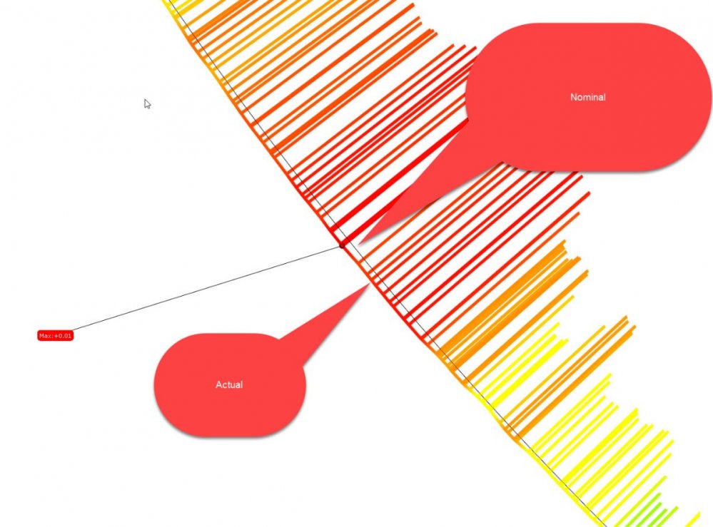

I have a questions regarding the vector visualization for color deviation representation for a roundness.
When I enable the vector representation and if I change the size of the vectors they are inverted (please see picture in attachment). I can't show the part here, but it's an round cylindrical shaped part, so the circle for the roundness is on the outside of the part. You see on the Min/Max labels, that the vectors are inverted, which is confusing.

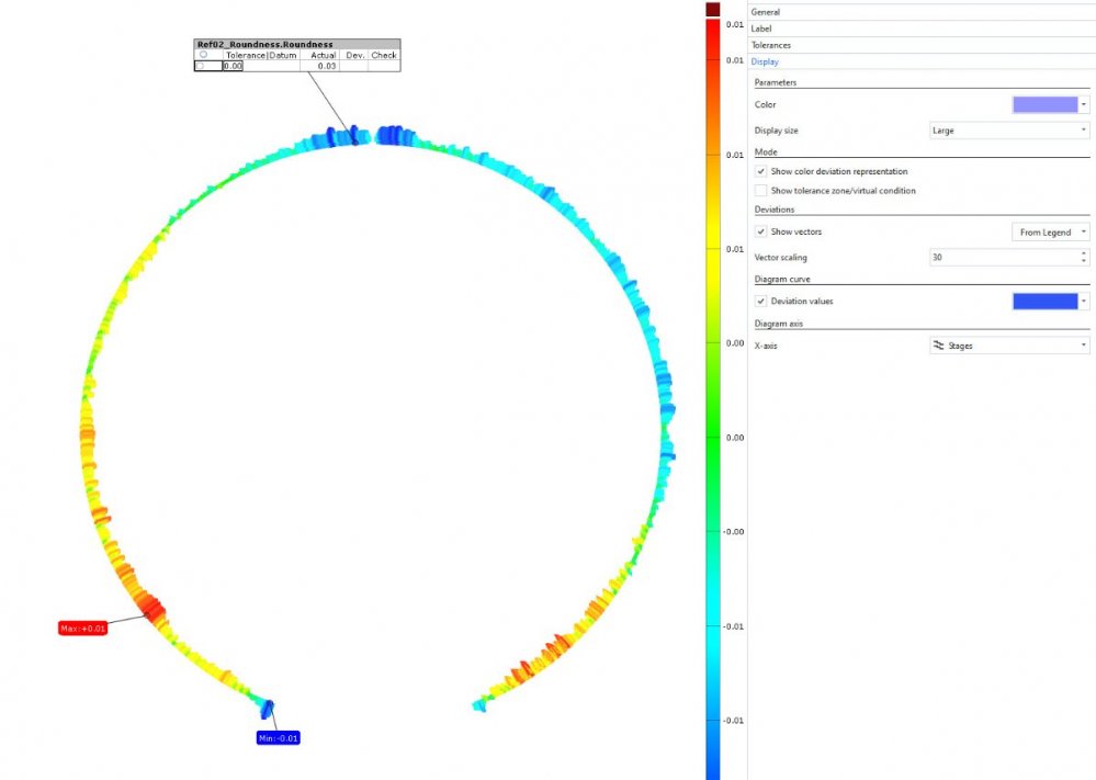

In the second picture it's visible, that the vectors are pointing towards the nominal section.
Is there a way to change the behaviour or am I misinterpreting results?

Hi,
for GD&T evaluations we always show the deviation from actual to nominal. In the moment there is no possibility to change this.
