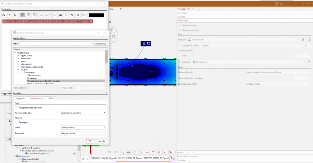

[Ma...] Posted April 26, 2021 Share Posted April 26, 2021 Hi, I would like to knoiw if there is the possibility to create a label deviation with the absolute value deviation (without sign). Thank you very much. Link to comment https://qualityforum.zeiss.com/topic/190-label-deviation-without-sign-abolute-value/ Share on other sites More sharing options...

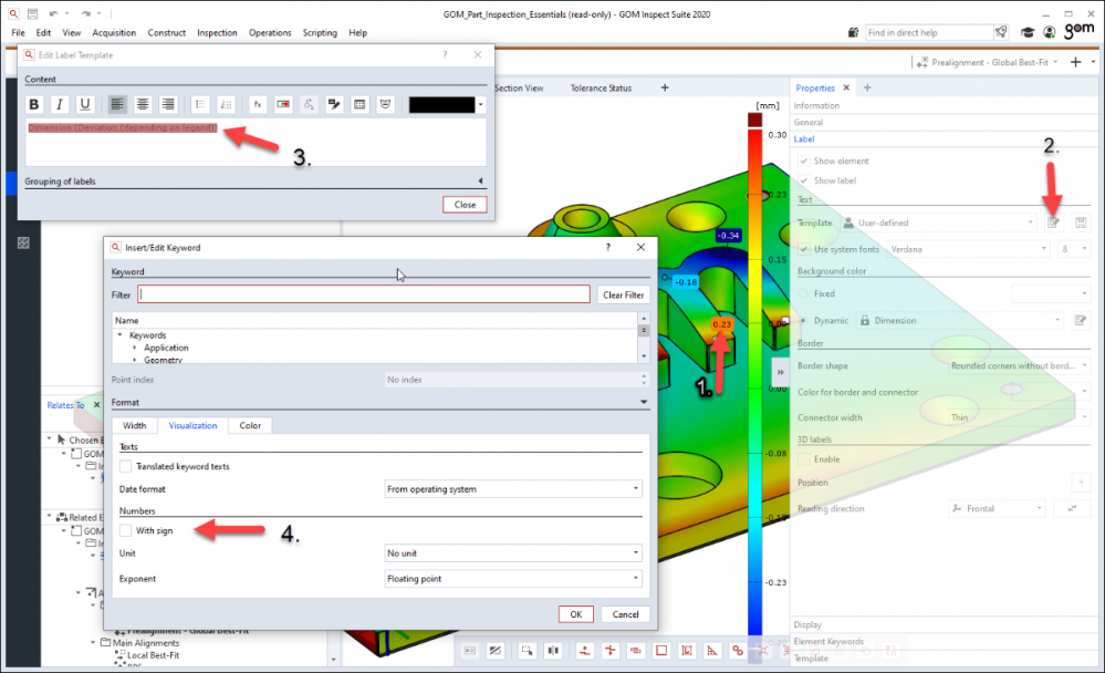

[Na...] Posted April 26, 2021 Share Posted April 26, 2021 Hello Marco, you can uncheck the box "With sign" when you edit the label. At step 3. double click on the keyword to edit. Regards Nanno Link to comment https://qualityforum.zeiss.com/topic/190-label-deviation-without-sign-abolute-value/#findComment-541 Share on other sites More sharing options...
[Ma...] Posted April 27, 2021 Author Share Posted April 27, 2021 I saw this option. but It doesn' work for me. Link to comment https://qualityforum.zeiss.com/topic/190-label-deviation-without-sign-abolute-value/#findComment-544 Share on other sites More sharing options...

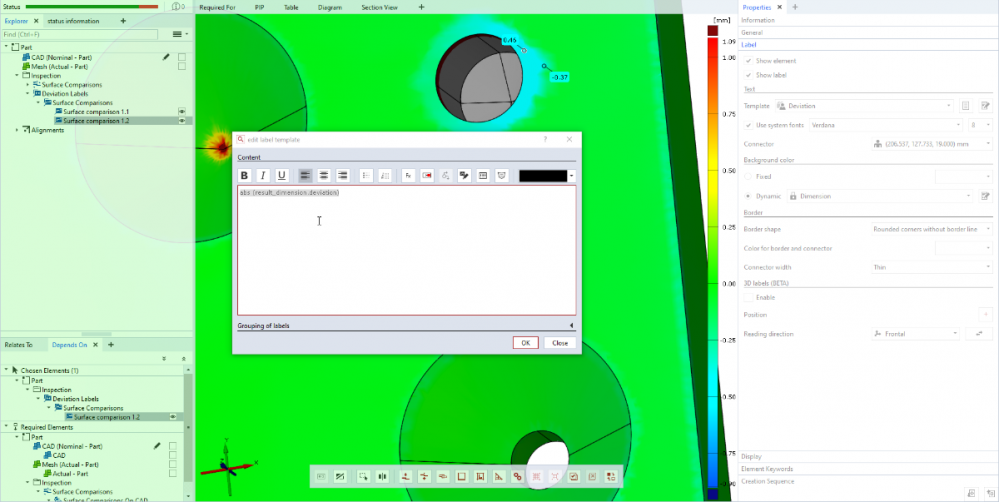

[Be...] Posted April 30, 2021 Share Posted April 30, 2021 Hi, if you want to show negative values as absolute values you have to create your own label template where you work with user defined expression. An image to get an impression what is possible: You can see two picker, both are placed in an area where you have a negative deviation (to less material). For one picker I changed the expression with the function abs. But is this really helpful to see different values than the legend of your colorplot indicates? Usually not, but as you can see you are able to show different values derived from the computed one. Hope this helps?! Regards Link to comment https://qualityforum.zeiss.com/topic/190-label-deviation-without-sign-abolute-value/#findComment-571 Share on other sites More sharing options...
