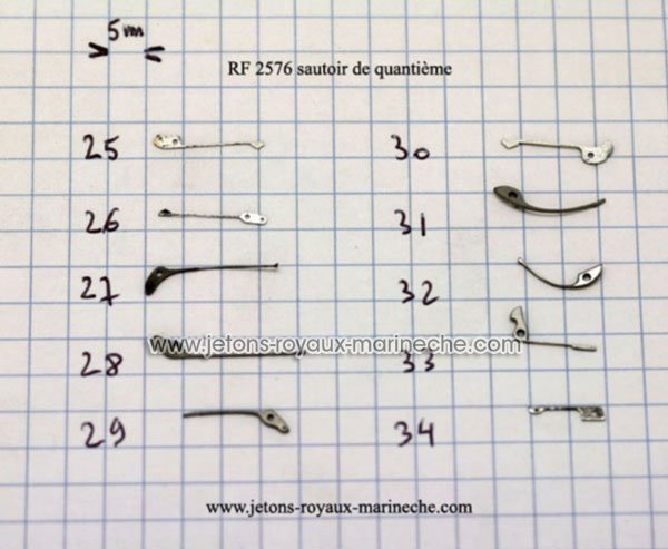

[Me...] Posted February 25, 2019 Share Posted February 25, 2019 Hello, I try to find the fast way to control Z location (GPS cotation) of a watch spring. [img]https://www.jetons-royaux-marineche.com ... me__2_.jpg[/img] The spring has a reference surface and two holes to fix it on watch. The measure is done at the end of blade and tolerance is 50microns. I have a 100% sorting to do (lot size is about 60parts) and can't make a tooling to make an autorun. The best thing will be to have a form recognition to automaticaly detect my two references (the holes) and run the measure cycle automatically (and idealy repeat the measurement with regular spacing not accurate). Thanks for your future help!!!! Best Regards Cédric Link to comment https://qualityforum.zeiss.com/topic/19210-z-location-with-cfs-on-o-inspect-543/ Share on other sites More sharing options...

[Me...] Posted February 26, 2019 Author Share Posted February 26, 2019 The part drawing is here: [img]https://image.noelshack.com/fichiers/20 ... oc-z-1.png [/img] I make my origin with the hole 213 and make my alignment by construction with a straight between holes 213-214 (measured with camera). I make my vertical origin by construction of the A plan (probing with CFS). After that, I go to the Z zone and make a plan by CFS probing. Finaly, I call a localisation ISO tolerance between A and Z. (I have a 50µ tolerance) Measuring condition are: Part positioned freely on a glass plate Face-up orientation on the glass Part without any contraint On my OGP ZIP250 machine, I have an autocorrelation system and it permit a fast hole detection (without a precise positioning). After the autcorrelation, I can change the zoom automaticaly and have precise measure of 213 and 214. But I don't have CFS system on my OGP... Is there the same fonction on O-Inspect? Thanks Link to comment https://qualityforum.zeiss.com/topic/19210-z-location-with-cfs-on-o-inspect-543/#findComment-108086 Share on other sites More sharing options...
