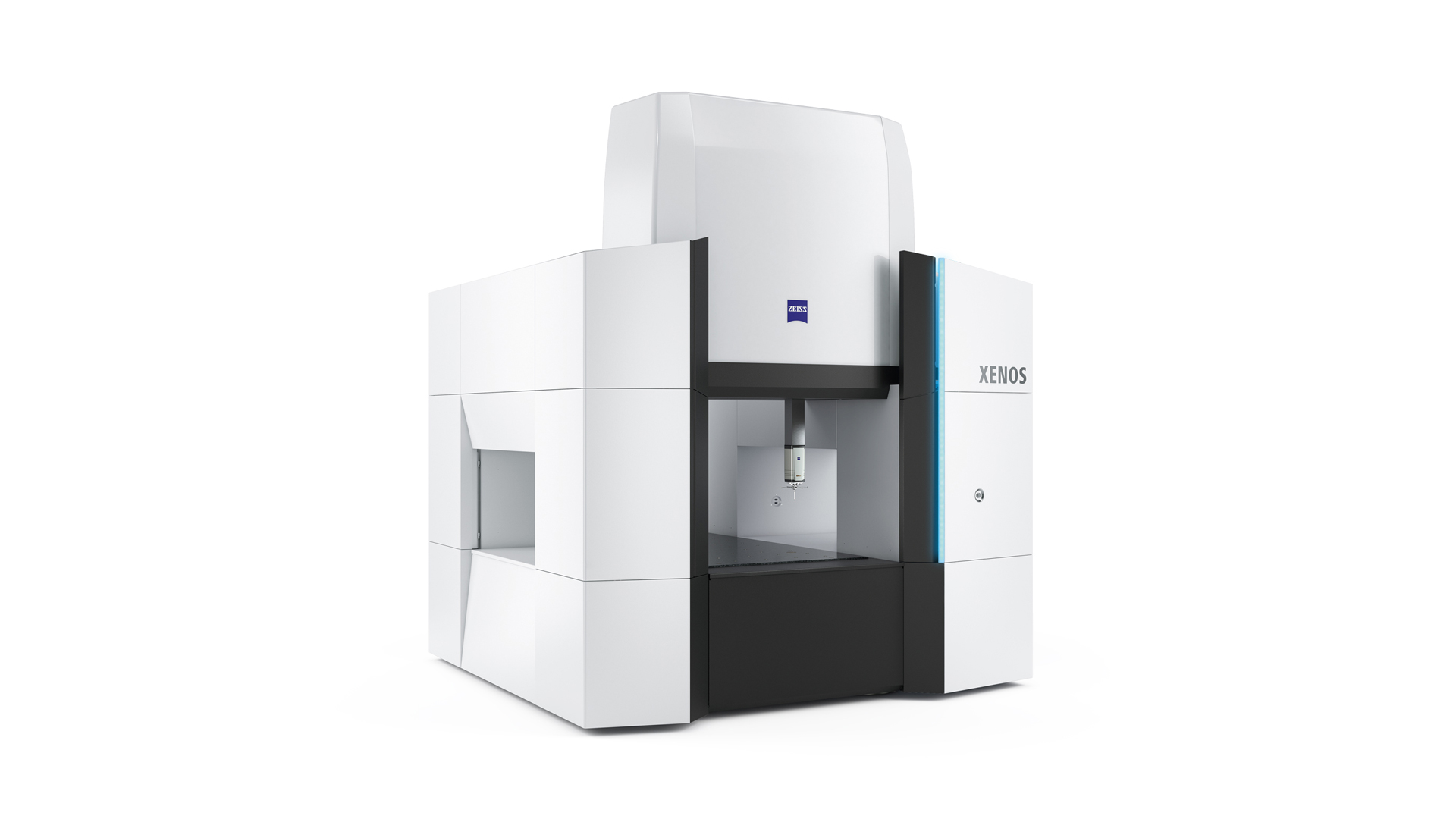

[Ri...] Posted January 4, 2019 Share Posted January 4, 2019 Of course Renishaw is going to be biased when it comes to Active vs Passive scanning. I've seen numerous arguments from them, and in my 10+ years of Metrology experience I can safely say this - Active > Passive - no contest. Any time them or someone else wants to gripe about uncertainty in an Active scanning head, just show them this..... https://www.zeiss.com/metrology/product ... xenos.html [img]https://www.zeiss.com/content/dam/metro ... -image.jpg[/img] Link to comment https://qualityforum.zeiss.com/topic/19614-active-scanning-described-by-renishaw/#findComment-110290 Share on other sites More sharing options...
[Ri...] Posted January 4, 2019 Share Posted January 4, 2019 Maybe I should clarify something too.... Zeiss Active scanning. I cannot speak to the other guys who have developed their own Active scanning heads. Link to comment https://qualityforum.zeiss.com/topic/19614-active-scanning-described-by-renishaw/#findComment-110292 Share on other sites More sharing options...
[Me...] Posted January 4, 2019 Author Share Posted January 4, 2019 Please sign in to view this quote. Correct me if I am wrong, but I believe Zeiss are only guys that have Active scanning heads. I know this was definitely true at one time. I am unaware of any other competitors that have developed this and have machines equipped currently though. Link to comment https://qualityforum.zeiss.com/topic/19614-active-scanning-described-by-renishaw/#findComment-110294 Share on other sites More sharing options...
[Ri...] Posted January 4, 2019 Share Posted January 4, 2019 Please sign in to view this quote. I know that Leitz has their own - they may not call it Active Scanning, but it handles up to 1000g and 800mm in length probe - no way a Passive Scanning head is doing that. Mitutoyo has their own scanning heads that look like Active Scanning heads as well. Link to comment https://qualityforum.zeiss.com/topic/19614-active-scanning-described-by-renishaw/#findComment-110296 Share on other sites More sharing options...
