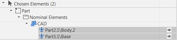

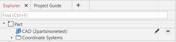

[ph...] Posted April 29, 2021 Share Posted April 29, 2021 Hi , i am using a script which imports a .catpart from a nominated folder the CAD part is made up of multiple components and then i export in stl format and select 'multiple parts' ready for 3d printing. Each component of the .catpart then is assigned the name of the original part with externsion 00 , 01 , 02 etc. is there a way of naming each stl as the components listed under the main CAD part? Link to comment https://qualityforum.zeiss.com/topic/197-script-to-import-a-cad-assembly-and-export-as-an-stl-for-3d-printing/ Share on other sites More sharing options...
[An...] Posted April 29, 2021 Share Posted April 29, 2021 Hello Phil, maybe something like this will help you... # -*- coding: utf-8 -*- import gom # Default directory DIR = 'C:/tmp/' # loop over all parts for part in gom.app.project.parts: # loop over all bodies for body in part.nominal.bodies: # get the name of the body name = body.name # export the body into a stl file with the name of the body gom.script.sys.export_stl ( bgr_coding=False, binary=True, color=False, elements=body, export_in_one_file=True, export_stages_mode='current', file=DIR+name+'.stl', length_unit='default', set_stl_color_bit=False) Link to comment https://qualityforum.zeiss.com/topic/197-script-to-import-a-cad-assembly-and-export-as-an-stl-for-3d-printing/#findComment-558 Share on other sites More sharing options...
