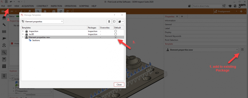

[Ro...] Posted November 19, 2020 Share Posted November 19, 2020 Version V2019 had "Save Properties" button and "Save skin" option. How to do it in V2020 ? Link to comment https://qualityforum.zeiss.com/topic/20-how-to-save-changed-color-for-nominal-section-as-default-color-for-future-sections-v2020/ Share on other sites More sharing options...

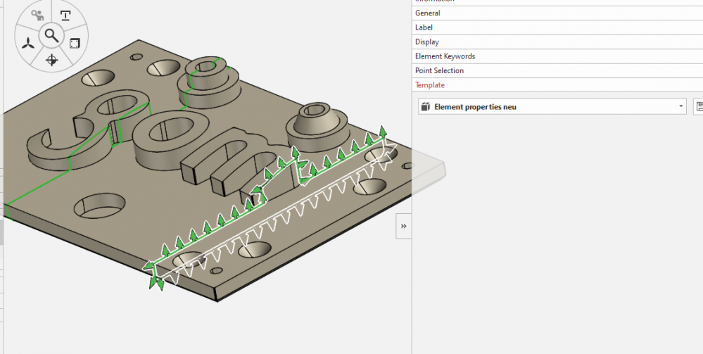

[Ch...] Posted November 23, 2020 Share Posted November 23, 2020 In the Properties you have a Properties Template for each Element. Standard Element Properties can be defined via Edit/Manage Template. I'd recommend to create Element Properties Templates put them into a Package and set this as standard via Manage Templates. Advantage in here is that you can see now the Standard Properties you have defined, e.g. for the section. Link to comment https://qualityforum.zeiss.com/topic/20-how-to-save-changed-color-for-nominal-section-as-default-color-for-future-sections-v2020/#findComment-54 Share on other sites More sharing options...
