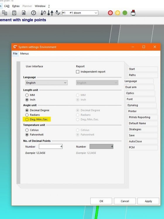

[Ro...] Posted November 11, 2024 Share Posted November 11, 2024 Hi guys, hoping I'm asking in the right place as this is my first post. I think its a relatively simple question. I recently took over CMM operation from our old guy, who on his reports always had angles reported as non degree numbers, eg: 80° is currently being reported as 1.4035 instead of 80°. When I open the feature itself, it shows as 80°±2° which is correct, but it just will not report that way no matter what I try. Please someone help! Link to comment https://qualityforum.zeiss.com/topic/21198-how-to-get-a-cone-angle-to-report-as-an-angle/ Share on other sites More sharing options...
[Du...] Posted November 11, 2024 Share Posted November 11, 2024 I think this should solve your problem, try it out and let me know if it works for you, go under settings - environment, then there should be a language tab with the different types of angles Link to comment https://qualityforum.zeiss.com/topic/21198-how-to-get-a-cone-angle-to-report-as-an-angle/#findComment-121008 Share on other sites More sharing options...
[Ro...] Posted November 11, 2024 Author Share Posted November 11, 2024 Please sign in to view this quote. Thanks for the reply! I actually figured it out in a different area ( Measurement Plan Editor Features > Angle Units- Set to degrees) but I don't see an Environment setting in the CMM settings. Could you walk me through that navigation? I should have noted, we are still running Calypso 2016. Link to comment https://qualityforum.zeiss.com/topic/21198-how-to-get-a-cone-angle-to-report-as-an-angle/#findComment-121010 Share on other sites More sharing options...
[Du...] Posted November 11, 2024 Share Posted November 11, 2024 I Completely forgot about that, that would work just as well, i think it would only be for that program though, the way I did should change that to the default method. I attached a video of how to get there Desktop 2024.11.11 - 16.13.16.04.mp4 Link to comment https://qualityforum.zeiss.com/topic/21198-how-to-get-a-cone-angle-to-report-as-an-angle/#findComment-121014 Share on other sites More sharing options...
[Ro...] Posted November 12, 2024 Author Share Posted November 12, 2024 Please sign in to view this quote. Fantastic, that worked for me. Thanks so much! Link to comment https://qualityforum.zeiss.com/topic/21198-how-to-get-a-cone-angle-to-report-as-an-angle/#findComment-121040 Share on other sites More sharing options...
