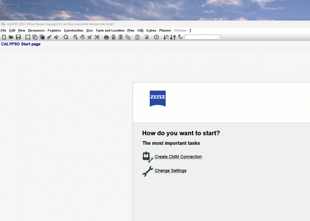

Is there a way to force Calypso to start maximized?
I have Calypso v2022 (latest rev) and it always starts about an inch below full screen.
It's the only install like this, all the others are minimally off maximized.
It's an OCD thing. 😎
I used to be able manually adjust the size of the window to fit as much of the screen as possible manually, terminate Calypso, restart, and it would stay that size.
That doesn't appear to work anymore.

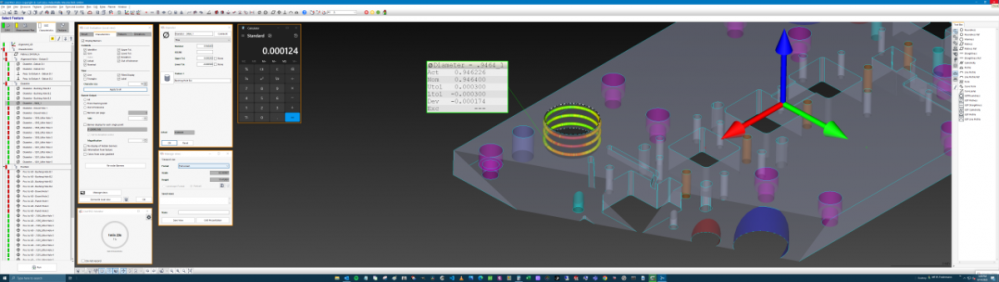

I got an idea for those big screens.
This app could store actual positions and sizes so everytime you open Calypso it will fit onetime to that save location.
Something similar came to my mind for feature window to have set location. I am not happy to have that window right around mouse and that other method is not good for me.
