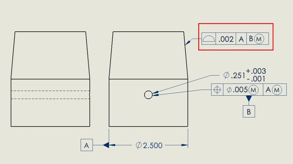

[Al...] Posted November 12, 2024 Share Posted November 12, 2024 Hi Guys, first time posting here so I'm hoping I am in the right place. I am trying to evaluate this profile that includes an MMB modifier. I have calypso 2019 and 2022 so I don't currently have access to the Beta GD&T engine. I'm wondering if there is some sort of a formula that I can use to apply this MMB modifier. Link to comment https://qualityforum.zeiss.com/topic/21208-evaluating-mmb-modifier-within-calypso/ Share on other sites More sharing options...
[Ma...] Posted November 13, 2024 Share Posted November 13, 2024 Here (B) controls only direction along (A) axis within .004 tolerance, rotational is irrelevant. Andreas told something about in ASME ( if i remember it correctly ) that (B) have to be perpendicular to (A) so you could make 2 alignments where one will have lower state and second will have upper state. This is type of drawing, where it should be better to have it in standard callouts - form, diameter, concentricity in my opinion. Link to comment https://qualityforum.zeiss.com/topic/21208-evaluating-mmb-modifier-within-calypso/#findComment-121062 Share on other sites More sharing options...
[Ma...] Posted November 13, 2024 Share Posted November 13, 2024 I made a mistake on stating that (B) have to be perpendicular to (A) - (B) should be fixed to it's nominal vector - at least i think 😂 Link to comment https://qualityforum.zeiss.com/topic/21208-evaluating-mmb-modifier-within-calypso/#findComment-121064 Share on other sites More sharing options...
