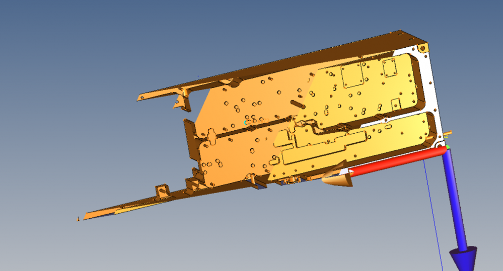

[ce...] Posted November 19, 2024 Share Posted November 19, 2024 I am using version 6.0 2015. the cad model partially disappears when I rotate. I have upgraded the video card. It only does it on one program that it didn't use to. Is there a setting where I can fix. Any help is appreciated. Link to comment https://qualityforum.zeiss.com/topic/21258-cad-model-breaks-up/ Share on other sites More sharing options...
[Br...] Posted November 26, 2024 Share Posted November 26, 2024 Hello, First make sure your video card is set correctly. right click desktop and choose Nvidia control panel Choose "manage 3d settings" on the left menu From the global pulldown select "autodesk motion builder compatible" hit apply restart Calypso Link to comment https://qualityforum.zeiss.com/topic/21258-cad-model-breaks-up/#findComment-121784 Share on other sites More sharing options...
