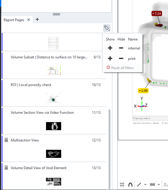

[Jo...] Posted November 19, 2024 Share Posted November 19, 2024 Hello, I want to ask if anyone know if its possible disable report pages for printing? At another software I usually create some report pages just to check the calculations or specific zones, but I don't want print this report pages, it's just for a fast check before print pdf report. Link to comment Share on other sites More sharing options...
[Na...] Posted November 19, 2024 Share Posted November 19, 2024 Hello Jorge, you can assign tags also to report pages (select pages -> Edit -> Define Tag or shortcut T) and filter them with +-. Only visible pages will be printed. Nanno Link to comment Share on other sites More sharing options...

[Ju...] Posted December 2, 2024 Share Posted December 2, 2024 It's so nice and smart !!!! Thanks, Nanno ! I'm using GOM/ZEISS inspect for so many years and still discvover some features... Cheers, Julien Link to comment Share on other sites More sharing options...
