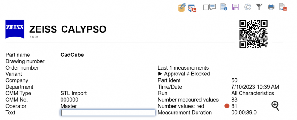

[Mi...] Posted November 20, 2024 Share Posted November 20, 2024 Is there a way to have a Barcode or 2D Matrix on the report that contains information from your other header variables? This would be very useful for our process, we could make Operators scan their printed reports at other measurement stations and tie all the data together pretty nicely. I was hoping for a really simple barcode font and a text box but that was wishful thinking. Link to comment https://qualityforum.zeiss.com/topic/21290-barcode-generation/ Share on other sites More sharing options...
[Ri...] Posted November 20, 2024 Share Posted November 20, 2024 Yes - you can add a Barcode to the report: Toolbox - General - Barcode. From there, you would set the Barcode Properties to: Type - QR code or Data matrix code Payload - Text Text - This is where you can input header variables that you'd like imbedded. Here is an example that will show the Part name; CMM Type; Operator - they are separated by an enter ${Qdb.Part(1002)} ${ToString(Qdb.Measurement(12, -1, 4073))} ${Qdb.Measurement(8, -1)} Link to comment https://qualityforum.zeiss.com/topic/21290-barcode-generation/#findComment-121578 Share on other sites More sharing options...

[Ri...] Posted November 21, 2024 Share Posted November 21, 2024 Yes - it appears that it was added in Calypso 2022 - PiWeb version 8.2 Link to comment https://qualityforum.zeiss.com/topic/21290-barcode-generation/#findComment-121622 Share on other sites More sharing options...
