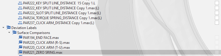

Hello,
I am trying to extract the scalar abbreviation from Inspection elements, mainly dimensions and deviation labels.
See image below:
So from top to bottom, I would expect:
L, max(L), max(L), max(L), max(L), max, max, max, max.
For most elements, when I use the reference 'scalar_type_abbreviation', it is not the same abbreviation as in the explorer. For example, the call I use, for a cylinder:
print(gom.app.project.inspection['A07_OUTER DIAMETER Copy 1.Ø'].scalar_type_abbreviation)
Returns D.
Is there a way to return the abbreviation?
I would prefer not to extract the value from the name, since the name can be edited, and I am trying to align names across projects.
Thank you,
Best regards
Emil.
