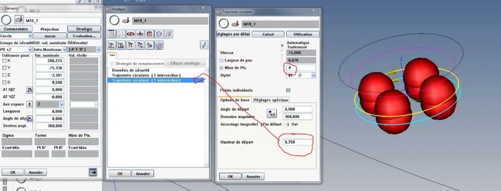

[ni...] Posted November 26, 2024 Share Posted November 26, 2024 (edited) Hi, for thread I mesure circle with two trajectory of 4 points, the second one with an offset half of the pitch (the M10*1.5 is 0.75 hight), and a Ø stylus at list 2* the pitch( 3* is better) simple and work very fine if the pre-hold is straight in line. Edited November 26, 2024 Link to comment https://qualityforum.zeiss.com/topic/21324-new-user-with-a-question-about-thread-following-in-calypso/#findComment-121768 Share on other sites More sharing options...
