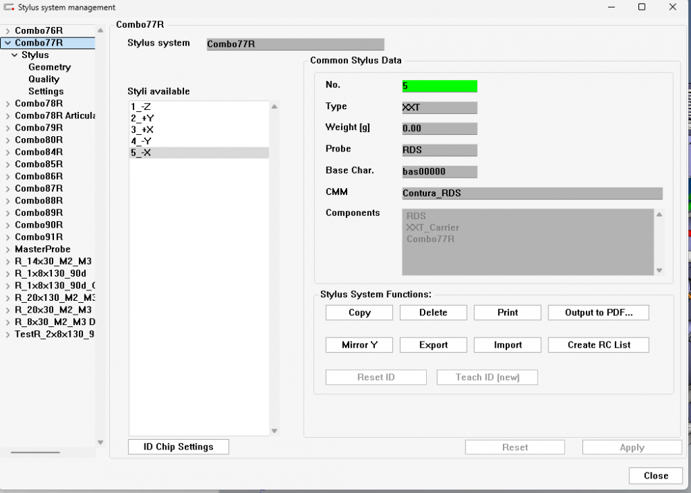

[Ri...] Posted November 26, 2024 Share Posted November 26, 2024 How do you send stylus data to a PDF file? it doesn't seem to work. I select "Output to PDF" and a file dialog box opens asking the user to give the file a name. I give it a name. Then another dialog box opens presumably to select what data to output? I make selections and select "OK" No file is generated. Does this not work or am I doing something wrong? Link to comment https://qualityforum.zeiss.com/topic/21332-stylus-system-managment-output-to-pdf/ Share on other sites More sharing options...
[Th...] Posted November 26, 2024 Share Posted November 26, 2024 Works for me on both 2020 and 2024. Do you have the old Zeiss PDF printer drivers installed? That's what Calypso uses to generate it. Link to comment https://qualityforum.zeiss.com/topic/21332-stylus-system-managment-output-to-pdf/#findComment-121802 Share on other sites More sharing options...
[Ri...] Posted November 26, 2024 Author Share Posted November 26, 2024 I have a Zeiss Printer installed. Not sure what version should have come with v2022. Do i have to set that as default? Link to comment https://qualityforum.zeiss.com/topic/21332-stylus-system-managment-output-to-pdf/#findComment-121806 Share on other sites More sharing options...
[Th...] Posted November 26, 2024 Share Posted November 26, 2024 Shouldn't need to be set as default, mine isn't and it works fine. I don't think the driver versions have changed in years, either, one of them is 5.5 and the other is 7.7. Link to comment https://qualityforum.zeiss.com/topic/21332-stylus-system-managment-output-to-pdf/#findComment-121814 Share on other sites More sharing options...
[Ri...] Posted November 26, 2024 Author Share Posted November 26, 2024 (edited) I have found they are just stuck in the Zeiss PDF Printer Queue for "Zeiss PDF Printer7". I can delete them, but they won't resume. Edit: I have both 5.5 and 7.7 installed along with NovaPDF 7.7. Edited November 26, 2024 Link to comment https://qualityforum.zeiss.com/topic/21332-stylus-system-managment-output-to-pdf/#findComment-121816 Share on other sites More sharing options...
[Th...] Posted November 26, 2024 Share Posted November 26, 2024 You could always try reinstalling them. I don't think there's supposed to be a third one there, just the 2 titled Zeiss PDF Printer and Zeiss PDF Printer7. Get rid of all 3, fetch the setup either from your existing install package or the portal (2023, additional files, PDF_Printer_new.zip) and execute the included VBE file, which handles the installation and the renaming that Calypso seems to require for some reason. If your machine is managed by an IT department you might need to involve them, executing VB files makes them nervous. Link to comment https://qualityforum.zeiss.com/topic/21332-stylus-system-managment-output-to-pdf/#findComment-121834 Share on other sites More sharing options...
