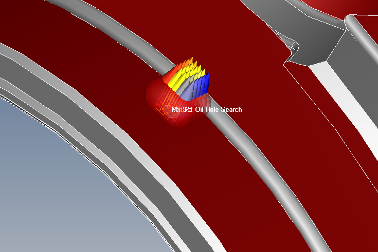

[Mi...] Posted January 23, 2025 Share Posted January 23, 2025 Please sign in to view this quote. Will need some more info but probably, that's a small hole with a large position allowance. Are you intending to self center with a larger ruby to help find the hole before measuring it properly with a smaller probe? I've done that, it works great with XT or XXT. IF the hole has a countersink, otherwise you risk the CMM missing altogether. If it's a production environment run by non-cmm programmers you don't want to risk that. However I've also done this in the case where there's no countersink. Scan a point set over the holes expected location, make sure it's large enough to capture the worst possible hole. Then set a "Minimum point" on your point set, and use that minimum point as your reference for finding the holes. If it's one hole using Meas. Ref. is probably fine, if it's a pattern using a secondary alignment that moves based on the minimum point is probably easier. or maybe I'm guessing wrong and my explanation is useless to your question! Link to comment https://qualityforum.zeiss.com/topic/21342-self-centering-probing/#findComment-124930 Share on other sites More sharing options...

[Jo...] Posted January 24, 2025 Share Posted January 24, 2025 Please sign in to view this quote. Hi Mike, Thanks for the feedback. This is for a production setting that will be checked by operators with limited experience. I do not have a .5mm tip in our rack at this time and wanted to avoid it unless absolutely necessary. These small tips tend to not last long as you could imagine. If this is necessary I would probably break this feature in its own program to prevent the entire program from being unusable on off shifts if the situation does arise. I do like the idea of scanning for min point for a rough location. I think I might give this a shot. Thanks again! Link to comment https://qualityforum.zeiss.com/topic/21342-self-centering-probing/#findComment-125000 Share on other sites More sharing options...

[Mi...] Posted January 24, 2025 Share Posted January 24, 2025 Please sign in to view this quote. If you attempt my suggestion, make sure the evaluation settings for the point is set to mid point. I forgot to include that. I use that method in a production environment where we have 1.5mm holes that I need to check with a 1mm ruby because I also don't want to go any smaller than that, so not much room for the hole to be in the wrong spot. I will say, as long as the hole you're measuring is well formed, I bet you will find my suggestion followed by the self centered point will be reliable enough for that huge 0.8mm tolerance. Be careful though, there's a lot of things that could affect it. Link to comment https://qualityforum.zeiss.com/topic/21342-self-centering-probing/#findComment-125004 Share on other sites More sharing options...
