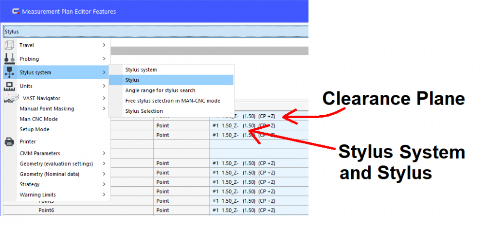

[Da...] Posted November 26, 2024 Share Posted November 26, 2024 Quick explanation of the part and what I'm trying to do: On my "machine alignment" (after the base alignment..), I had to take points on the bottom face of the part, which is datum A. I take 15 points, 10 of them with the stylus at 90° in the Y- direction, and the last 5 with the stylus at 90° in the X+ direction. My next dimension, I have to take a 'circle on a cylinder' of a PEM stud on the top side of the part, with the stylus at 0°/0°. My question is this: If I was programming in DMIS, I would put a machine move command after finishing the datum plane, Run the Z up about 6" to rotate the head, then measure the PEM stud. But, I can't find a "machine move" in Calypso. Does one exist???? Link to comment https://qualityforum.zeiss.com/topic/21344-machine-move-in-calypso-pc-dmis-guy-learning-calypso/ Share on other sites More sharing options...
[Ro...] Posted November 27, 2024 Share Posted November 27, 2024 This should all be done through your clearance planes that you set after setting your base alignment. When checking the plane, make sure your clearance plane is set to the first probe rotation (I take it by your description above that your probe is facing you at the Y- direction), so your clearance plane would be set to Y+. When you make the rotation to check the other 5 points on your plane, insert a clearance plane between the last point (point 10) and the first point of your next rotation (again, assuming -X). When you want to rotate to check the pin, make sure your clearance plane is set to Z+. The machine will automatically move to clearance distances to do the rotations without crashing into the part as long as everything is set correctly. Link to comment https://qualityforum.zeiss.com/topic/21344-machine-move-in-calypso-pc-dmis-guy-learning-calypso/#findComment-121846 Share on other sites More sharing options...
[Da...] Posted November 27, 2024 Author Share Posted November 27, 2024 (edited) Well, the issue is not the rotation inside the plane measurement; both are 90° and all the head needs to do is rotate in Z. The problem is AFTER that dimension, BEFORE the next dimension. In my plane measurement, I ended with a clearance plane in Y+, but the next dimension will be in the Z+ clearance plane. As of right now, the probe head lifts up to Z+ clearance plane, then moves to the PEM, STILL ROTATED to Y-! With a case like this in DMIS, I would add 1 command to raise an extra ~6" from the clearance plane, then another command to rotate, then continue. AFAIK, there seems to be no way to just put in a 'machine move' and a 'rotate head' command in Calypso. Am I missing something?? Do I need to add something else at the end of the plane measurement, or something on the PEM measurement command? Edited November 27, 2024 Link to comment https://qualityforum.zeiss.com/topic/21344-machine-move-in-calypso-pc-dmis-guy-learning-calypso/#findComment-121862 Share on other sites More sharing options...

[Da...] Posted December 3, 2024 Author Share Posted December 3, 2024 FWIW, I DID find a "machine move" for use on that A datum on the bottom of the part I was measuring; I went into the Strategies tab when I open the plane for editing, where it shows points and clearance planes. I deleted all the clearance plane moves between points to speed things up, and I noticed that there is a little box up on the top of that window which allows you to add probe moves. It gives you a chart showing all the locations of the points and moves, but they are all in machine coordinates, making for a bit of confusion. BUT, there is also an option of you moving the probe to exactly where you want it, then hitting a button to enter that move! OK, now I can speed things up AND not have to futz around with clearance planes in 3 directions on one feature! Link to comment https://qualityforum.zeiss.com/topic/21344-machine-move-in-calypso-pc-dmis-guy-learning-calypso/#findComment-122084 Share on other sites More sharing options...
