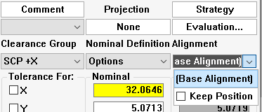

[76...] Posted November 27, 2024 Share Posted November 27, 2024 Thought I'd save time by adapting a program from existing. I applied transformations to all features on a round part lying with axis horizontal to axis vertical. (Using a little known procedure with Utility Alignments and the 'Keep position' checkbox) All appeared well and even ran well except for whenever a CNC exit from Clearance cube was called for. Despite me updating all Clearance planes to +Z Calypso insists on exiting in the +Y direction. Only by abandoning that Plan and copy pasting everything into a new blank Measurement Plan was this issue completely resolved. It would be nice if Zeiss added a 'Rotate Measurement Plan' function similar to the 'Mirror Measurement Plan' advanced command. Hope that helps anybody. Link to comment https://qualityforum.zeiss.com/topic/21362-rotating-a-measurement-plan-what-you-see-is-sometimes-not-what-you-get/ Share on other sites More sharing options...

[Mi...] Posted November 28, 2024 Share Posted November 28, 2024 It sounds like you had 1 of 2 issues. The Axis selections in the Base Alignment were wrong (Happens, especially when doing this you may not notice what it's done) You never went to Resources> Utilities> Set Base Alignment to Zero... so the software was still referencing the alignment prior to the flip. I have also done it Norberts way.. to be clear what he's saying is the Trihedron of the Base Alignment does not have to match the machine..... I have a machine that's longer in X than in Y so we actually load the machine from the +X Side... The "Front" stylus on that machine is at +X not -Y. This allows us to have the same program on two different machines, rotated 90 degrees from eachother. Took a bit to wrap my head around it at first, but it's actually easier when you stop thinking about it. Link to comment https://qualityforum.zeiss.com/topic/21362-rotating-a-measurement-plan-what-you-see-is-sometimes-not-what-you-get/#findComment-121948 Share on other sites More sharing options...
