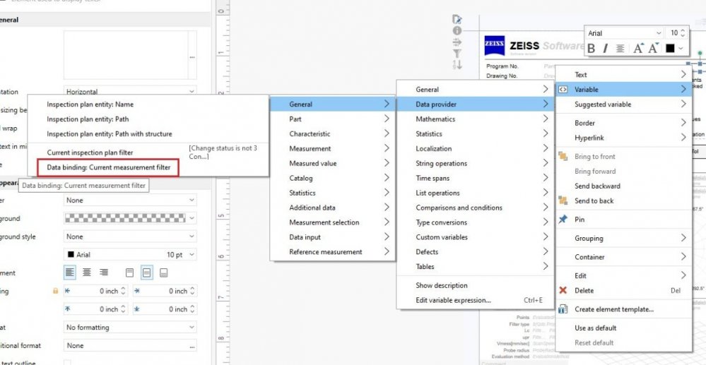

[Al...] Posted December 2, 2024 Share Posted December 2, 2024 Hello, is it possible to add the cycle time in the report? I didn't found the variable in the list Link to comment https://qualityforum.zeiss.com/topic/21380-cycle-time/ Share on other sites More sharing options...

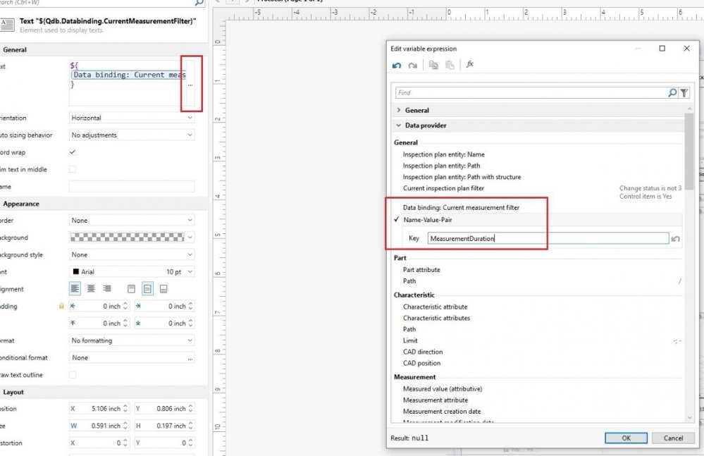

[Ri...] Posted December 2, 2024 Share Posted December 2, 2024 Measurement Duration is listed at the bottom right of the header. ${Qdb.Property("MeasurementDuration")} Link to comment https://qualityforum.zeiss.com/topic/21380-cycle-time/#findComment-122026 Share on other sites More sharing options...
[To...] Posted December 2, 2024 Share Posted December 2, 2024 (edited) See attached and let me know if you get stuck on anything. Obviously, Richard's post is the quick and easy answer. My post gets deep into the weeds...LOL Not sure why that one is not a selectable from a list.... Edited December 2, 2024 Link to comment https://qualityforum.zeiss.com/topic/21380-cycle-time/#findComment-122028 Share on other sites More sharing options...
[Ri...] Posted December 2, 2024 Share Posted December 2, 2024 Tom, I believe because it isn't technically a variable in the normal sense. Notice how the parameter is QDB.Property and not something like Part, Characteristic, Measurement, or Measured Value. There are certain things that are stored in this field, Characteristics Comments are stored here as well. ${Qdb.Property("FeatureComment")} Link to comment https://qualityforum.zeiss.com/topic/21380-cycle-time/#findComment-122076 Share on other sites More sharing options...

[To...] Posted December 3, 2024 Share Posted December 3, 2024 (edited) Please sign in to view this quote. Does this mean I shouldn't be able to select it from a list? If you didn't look at a template that already had that field, you wouldn't know what to type into the field of the new template. Edited December 3, 2024 1 Link to comment https://qualityforum.zeiss.com/topic/21380-cycle-time/#findComment-122116 Share on other sites More sharing options...
