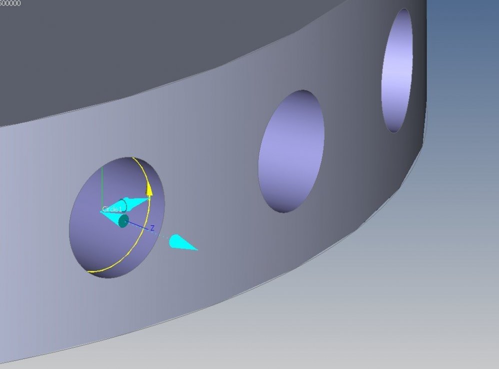

[To...] Posted December 5, 2024 Share Posted December 5, 2024 (edited) When measuring a group of features that require different RDS angles, when often ask ourselves "Why do I need to go all the way up to change the stylus angle when it would safe to just stay down. For years, I would incorporate Position Points after the strategy and modify the angle to what the next feature would use. This worked fine but was a lot of work. Today, I was trying to document the steps in order to help others. Then, I stumbled on using just Sub Clearance Planes with an adequate clearance distance to clear the part and it worked like a dream. In the screenshot below, each hole uses a different angle. I assigned SCP +X to all 3 circles and increased the Clearance Distance from my typical 0 to .600. The circles are measured .100 deep on a 3.5" radius disk, meaning I am .500 outside of the OD. I still plan to document the Position Points method because there could be an application where the above solution won't work. To get the blue arrows, go to CAD > Settings > Strategy and tick Clearance Positions. Note: you won't see the arrows if your Clearance Distance is zero. CAUTION: USING SUB CLEARANCE PLANES COULD BE HAZARDOUS TO SOMEONE'S HEALTH IN THE WRONG HANDS Edited December 5, 2024 Link to comment https://qualityforum.zeiss.com/topic/21436-saving-time-with-rds-indexes/ Share on other sites More sharing options...
[Ri...] Posted December 14, 2024 Share Posted December 14, 2024 Please sign in to view this quote. This will be handy when I use disc or L shaped probes. Great tip. Link to comment https://qualityforum.zeiss.com/topic/21436-saving-time-with-rds-indexes/#findComment-122684 Share on other sites More sharing options...
