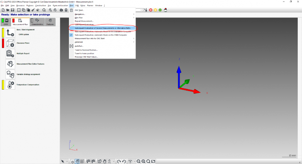

[Ri...] Posted December 11, 2024 Share Posted December 11, 2024 As long as you change your Environment Paths to be stored locally there are no issues with running over a network. I did it at my previous employer, and we had over 20 CMM across multiple facilities. The loading time are typically a network speed issue, and a lot of times related to the size of the CAD model stored in the measurement plan. You can change your settings in File - Load Settings to make it where the CAD Model doesn't load for a CNC run (or even have it only load the surfaces used). As for storing the Measured Points locally, there should be no issues with that (unless you are on something older than Calypso 2020 I believe). In the past, the Measured Points file(s) had to be stored in measurement plan folder, now you can load Measured Points via Plan - Subsequent Evaluation of Several Measurements or Alternative Paths Link to comment https://qualityforum.zeiss.com/topic/21478-measured-points-with-networked-programs/#findComment-122478 Share on other sites More sharing options...
