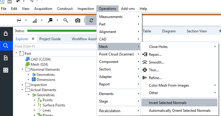

[Lu...] Posted December 13, 2024 Share Posted December 13, 2024 Hello, currectly i am trying to do an inspection of a ship's hull with cyclone 3DR as well as Zeiss inspect software. The data is from an RTC from Leica. We mesh it and compare it to CAD data (also in Mesh state). The problem i am having, is that the mesh data from the RTC is sometime a bit hard to control all the normal directions. Usually there is 30% normals just off, and the shapes of the data is just to complex to hand correct everything. When i use 3DR it ignores the normal direction, and instantly produces an inspection on both sides. Is Zeiss Inspect also capable of doing this? It would help a bunch, as i prefer the results using Zeiss inspect. Regards, Lucas Link to comment https://qualityforum.zeiss.com/topic/21506-3d-inspection-of-terrestrial-laserscanner-mesh-data-problem-with-normals/ Share on other sites More sharing options...
[Jo...] Posted December 13, 2024 Share Posted December 13, 2024 Hi Lucas, I'm not sure if it will help you or not, but its a menu where you can invert the mesh normals. Link to comment https://qualityforum.zeiss.com/topic/21506-3d-inspection-of-terrestrial-laserscanner-mesh-data-problem-with-normals/#findComment-122622 Share on other sites More sharing options...
