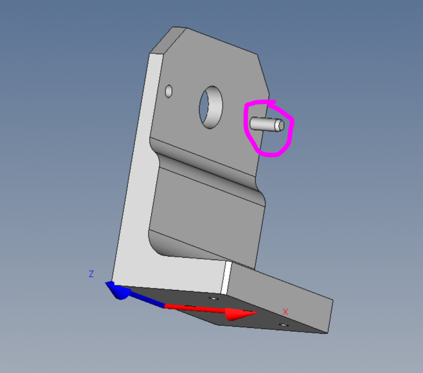

[Ra...] Posted December 13, 2024 Share Posted December 13, 2024 Hello, Is there a way to remove or hide the pin on the 3D model in Calypso 2022? Link to comment https://qualityforum.zeiss.com/topic/21512-how-to-remove-a-3d-model-feature/ Share on other sites More sharing options...
[Cl...] Posted December 13, 2024 Share Posted December 13, 2024 CAD > Creating Features > Hierarchy. Several CAD entities will be visible. Click on the model, it will highlight. Then expand (>) it and you can choose which entities to delete or hide. Link to comment https://qualityforum.zeiss.com/topic/21512-how-to-remove-a-3d-model-feature/#findComment-122590 Share on other sites More sharing options...
[Ch...] Posted December 13, 2024 Share Posted December 13, 2024 if for some reason they are all one body, you can click on the Modify CAD Entities > Edit tab and manually select all of the faces/geometry and delete that way as well. Link to comment https://qualityforum.zeiss.com/topic/21512-how-to-remove-a-3d-model-feature/#findComment-122596 Share on other sites More sharing options...
[Ma...] Posted December 13, 2024 Share Posted December 13, 2024 Click on CAD > Modify ( something ) - it will open window, where you can transform model. On first tab you can click on faces ( or select with ctrl and mouse move to select within rectangle ) and click "Remove" button. Link to comment https://qualityforum.zeiss.com/topic/21512-how-to-remove-a-3d-model-feature/#findComment-122598 Share on other sites More sharing options...
[Ra...] Posted December 13, 2024 Author Share Posted December 13, 2024 Thank you for your help. All options worked. Link to comment https://qualityforum.zeiss.com/topic/21512-how-to-remove-a-3d-model-feature/#findComment-122604 Share on other sites More sharing options...
