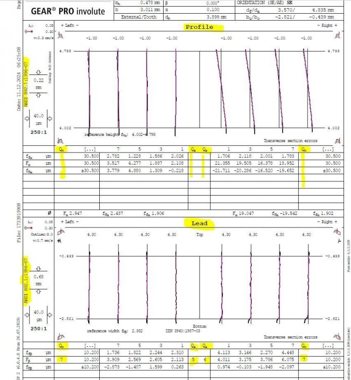

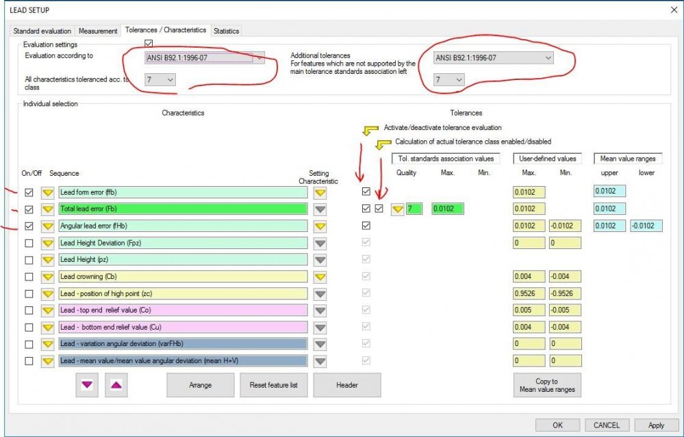

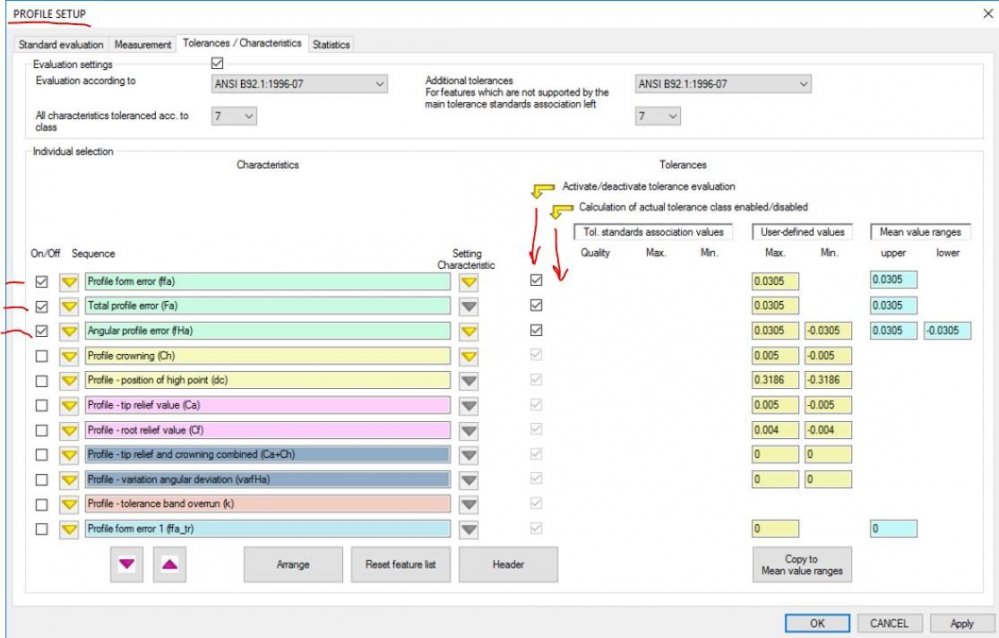

[Jo...] Posted December 17, 2024 Share Posted December 17, 2024 We have not issue of not able to get the Quality Class Nominals & Actuals data to show on the printout. We do not have the latest Revision & Patches, but have seen missing check boxes in the Tolerance tab. In our old previous version (2016) it's does shows, but after we upgraded to version 2018, it seems to be missing for the ones we enabled, Profiles & Leads. It's still showing for other features, just not on all of them. I have attached some pdf printouts and images detailing this issue. Hope someone may shed some light. Could be just parameters I'm missing, or maybe different version have different Quality Class table of Tolerances. Link to comment https://qualityforum.zeiss.com/topic/21534-gear-pro-qn-qa-not-showing-on-printout/ Share on other sites More sharing options...
[Ro...] Posted December 18, 2024 Share Posted December 18, 2024 Hello, if no tolerance class is offered, then the geometry data usually does not conform to the scope of the standard. For an accurate answer, I need either the .act file of the measurement or the complete geometry data accordingly. Link to comment https://qualityforum.zeiss.com/topic/21534-gear-pro-qn-qa-not-showing-on-printout/#findComment-122810 Share on other sites More sharing options...
